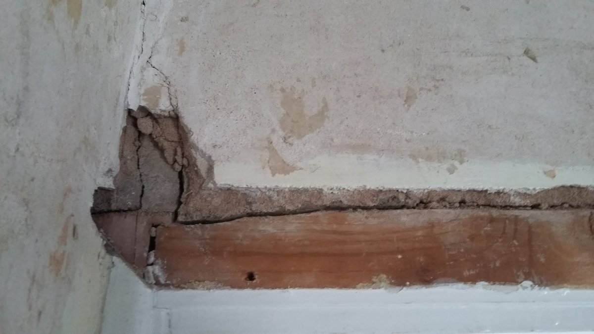

Above all the door lining sides is an upright of timber that appears to be embedded in the wall.

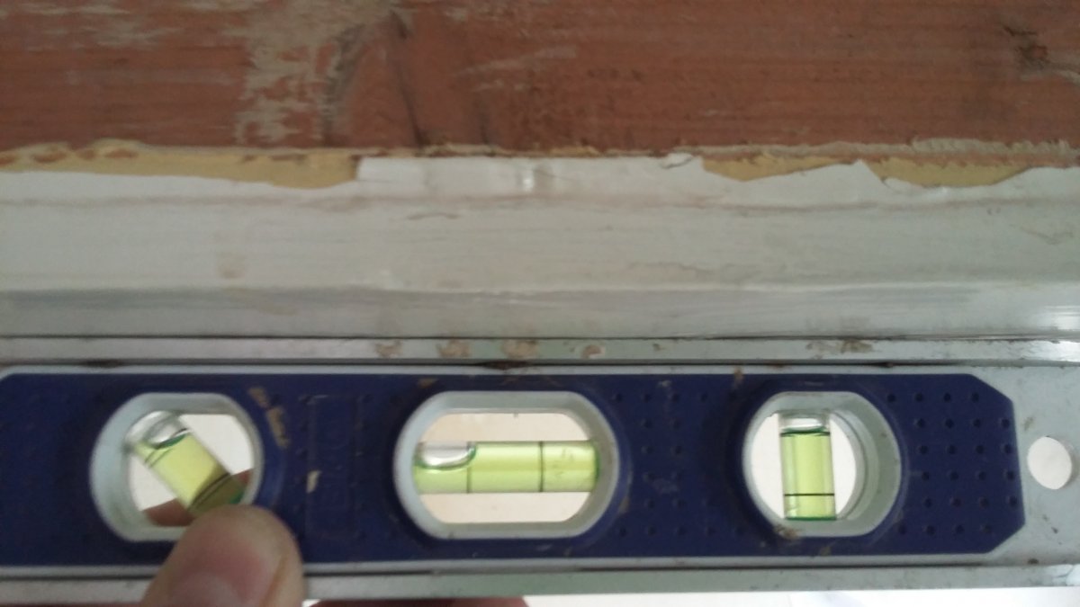

Also, another issue, I was planning to remove all the door linings and renew, but they are massive chunks of wood, probably due to holding up the walls above them, so I won't be doing this. However, i would like to level off the tops! A couple of them are an inch out! What is the best way to do this?
I thought about maybe using some new door lining and adding it into the existing frames, but this would make the frames at least 1.5inch shorter. Would this be acceptable?

There are timbers extending from the top corners of the frame up to the ceiling. Its as if they wanted to put a window in but decided to brick it up. But definitely no lintels.
In that case I'd install a reinforced concrete one and have done because a door frame/casing shouldn't ever be relied on in this way. What you have is a bodge job from the sound of it, and potentially unsound
I wouldn't call it unsound. Have you seen the thicknesss of the timbers? Anyway, all these are holding up is the blocks above the doors. Nothing above.
Definitely not a lath and plaster wall. 100% clinkerblock. It was a council house built in the 50s. At least some of these walls were actually built after the ceilings were boarded. And none of them have any support under them, built onto the floorboards wherever they were needed - not necessarily over a joist.
It's been accepted practice for more than 100 years that door and window openings require some form of lintel. Using the door casing as a support really is a bodge...... Beginning to wonder if that house was ever inspected by a Clerk of Works because the standard of building sounds truly awful

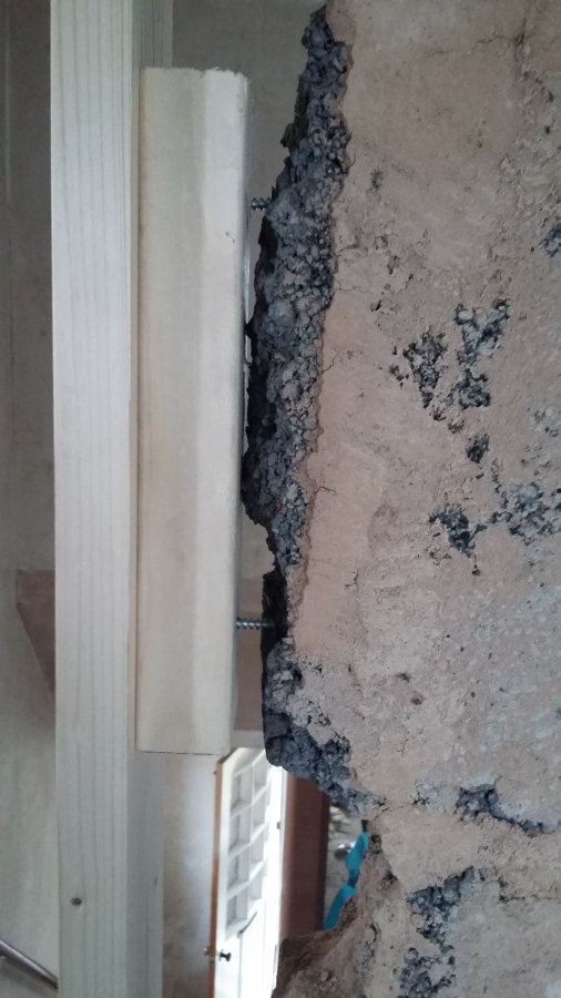

I've taken out all of the old door lining. I was going to leave the section attached to the brick wall but it was too chunky - the new lining wouldn't fit. So i took it all out. It was fastened together with 6 inch nails!
I have fastened the new lining straight to the wall on the right, then found a couple of good fixing points opposite as in the pictures. The door will hang from the right.
Should i attempt to secure it further or is this sufficient? I will be building a frame above it for boarding but this will afford little support as it will only be fastened to the ceiling and the right hand wall. The timber left poking out of the ceiling (just visible on the top left of the first photo) is only hanging there, just nailed into from above the ceiling. It cannot be used as support for anything, in fact i may remove it.
as long as its level, plumb and firm, but would prefer some restraint at the top and particularly the bottom, where you should be able to fix a block into the floor if the block work is a bit shonky. you could then get one side dot and dabbed and then fill the gap with foam or board adhesive.
My only criticism is that unless you have space constraints I would have brought the right hand side out from the wall so that you could get architrave on.
Fix your top frame to the top side and head of the lining that should be fine for a couple of bits of plasterboard that size.
