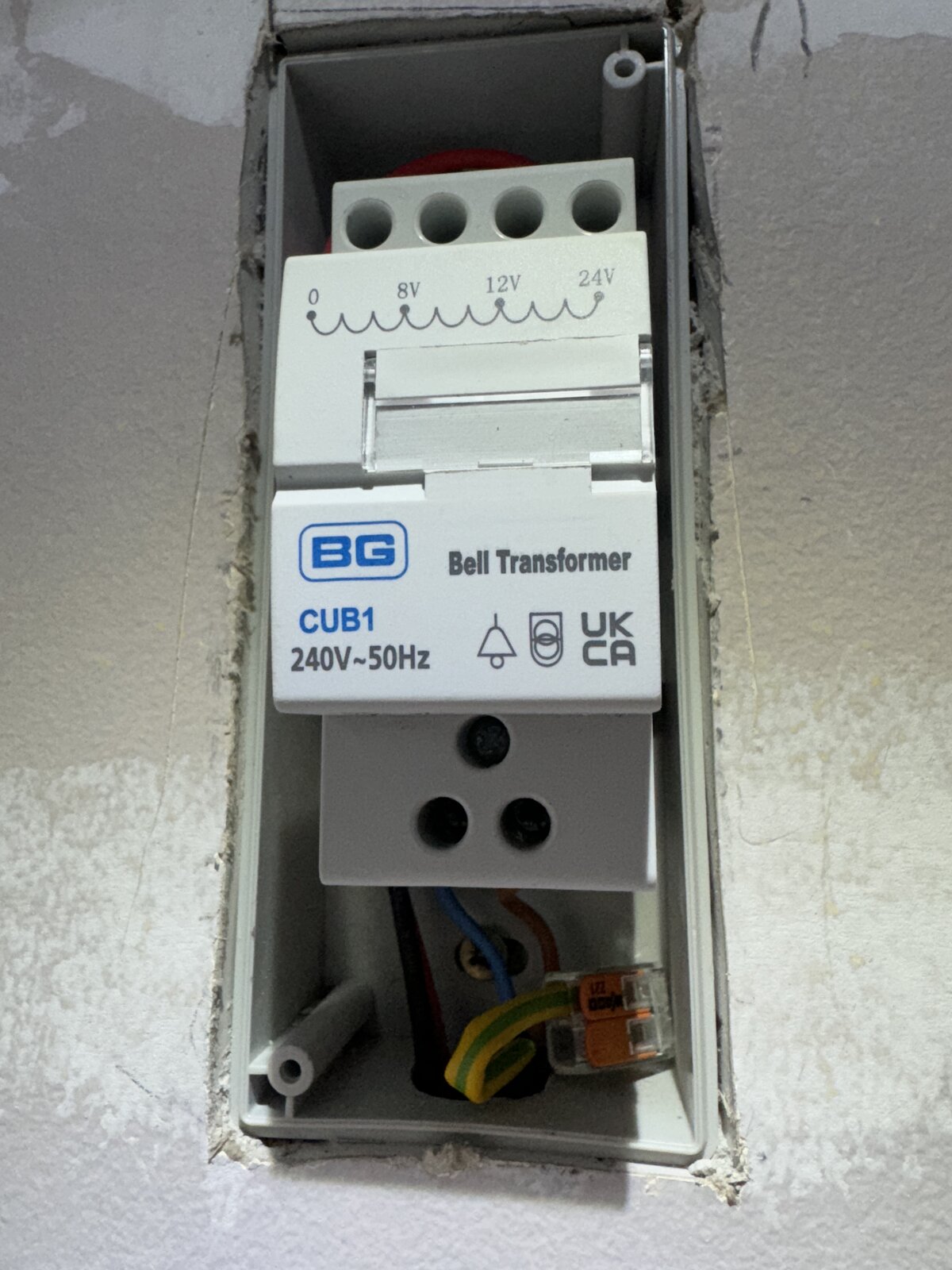

Doorbell transformer wiring
20 Oct 2010
928
20
Lanarkshire
New transformer install and I can’t see wiring diagram, can it go either way ?
The wiring diagram shows a transformer winding with taps at different voltages. It's alternating current AC.
So as long as one wire goes to the 0V terminal and the other to the correct Voltage of the bell / chime it doesn't matter which is which.
