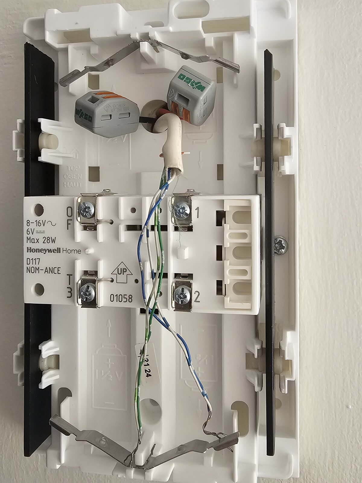

Could anyone tell me where these wires are ment to go any help would be much appreciated thanks

That will depend on what’s on the other ends of those wires. I guess you have a bell transformer somewhere? And a button? I guess that the 4-core wire with the blue/green/white striped cores goes to the button - check inside the button to confirm.
Thanks for the quick response mate,yip still trying to find out where the old bell transformer is as someone had installed a new bell but wasn't working Wonder why I do have a doorbell attached to door frame outside but never has worked

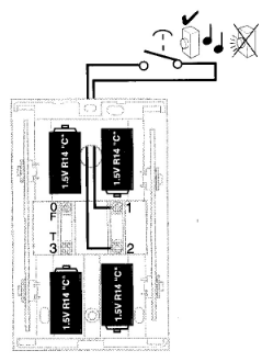

The 0F and T3 is the coil for the bell, and the 1 and 2 when batteries are fitted go to the bell push. If batteries are not used, and it uses a transformer instead, the 1 and 2 are handy terminals to join wires.

Isn't what you've written a little confusing? Surely 1 & 2 go to the bell push whether or not batteries are fitted (and also to the transformer/power supply if there are no batteries and power is coming from a transformer) - not just "when batteries are fitted"?

If bell push to 1 and 2 the transformer would need to go 0F to 1, and a link 2 to T3.
With a transformer, the voltage is 8 volts AC, and with batteries voltage 6 volts DC, the coil has a higher impedance with AC to its resistance with DC, so higher voltage, there is no way you can have a transformer and batteries, it is either/or not both.
I would say your description is very confusing, I read it "also to the transformer" that would be a direct short when the bell push is pressed. Also, massive difference between DC power supply and a transformer, the DC power supply would need a very high current and would need to be massive, and also a lower voltage, to AC. We see a transformer rated at around 8 VA, but when bell push is pushed it uses well over that current, around an amp, (16 VA) but for such a short time it does no harm to a basic transformer, a power supply with diodes in it however would be different. It could very well be damaged.

Yes, I was for from clear enough.
Agreed - as above, although my brain knew what I wanted to say, my typing fingers made a mess of it. Apologies.

Seems I made an error also, it is 8 volt AC. Thanks to @opps for finding the instruction set.
Why has no one asked what the red and black wires are?
Well spotted. I'll bet they were the L and N, which originally fed a transformer, wich then fed a bell. Since when, the transformer, and bell, has been replaced, with a newer chime, which used battery.
Bet, if the OP fitted a set of batteries, and reconnected those wires, to terminals 1 and 2, the chime would work.
Yes, it will have been a doorbell with a built-in transformer once upon a time.

My thinking with the “do you have a multimeter?” question was to follow up with “what do you measure on the wagos, 8 V AC, 240 V AC, or nothing?”.
