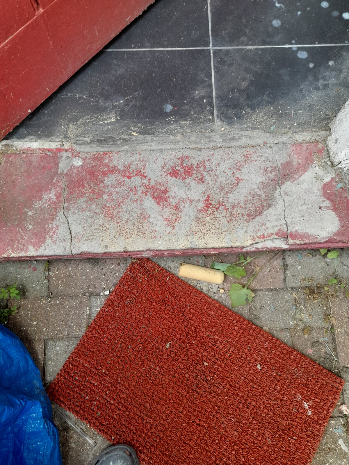

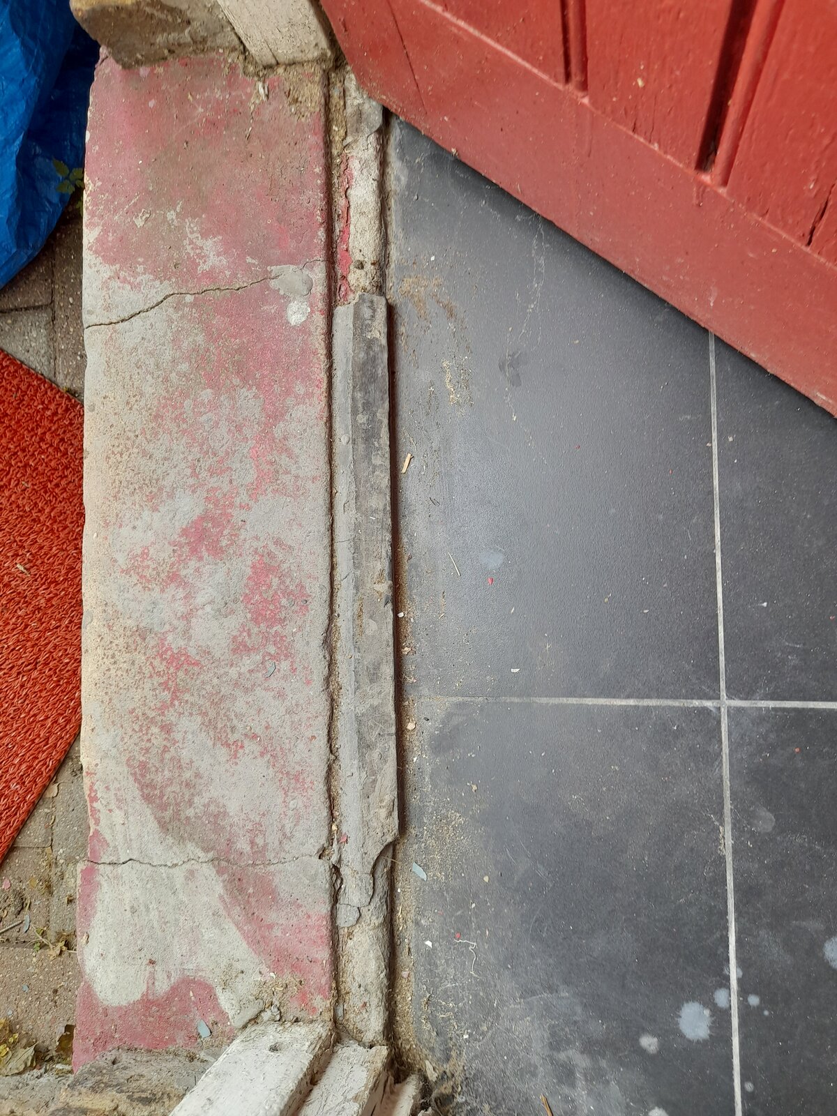

Hi all, I have a doorstep as pictured which requires some repair. Is there something I could use to fill the broken areas. I also have a (much less damaged) window cill that needs some filler.
What should I be using?
Thanks, Chris.

Buy new solid doorstep and replace or use some epoxy stone repair although I don't have any experience with it.
You could always cast a concrete one yourself in place.
Search for "stone crack filler" and you'll find products to fill the cracks in the doorstep.
