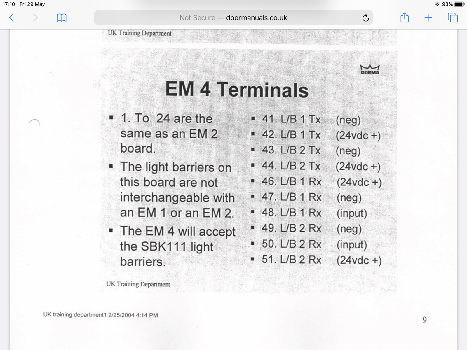

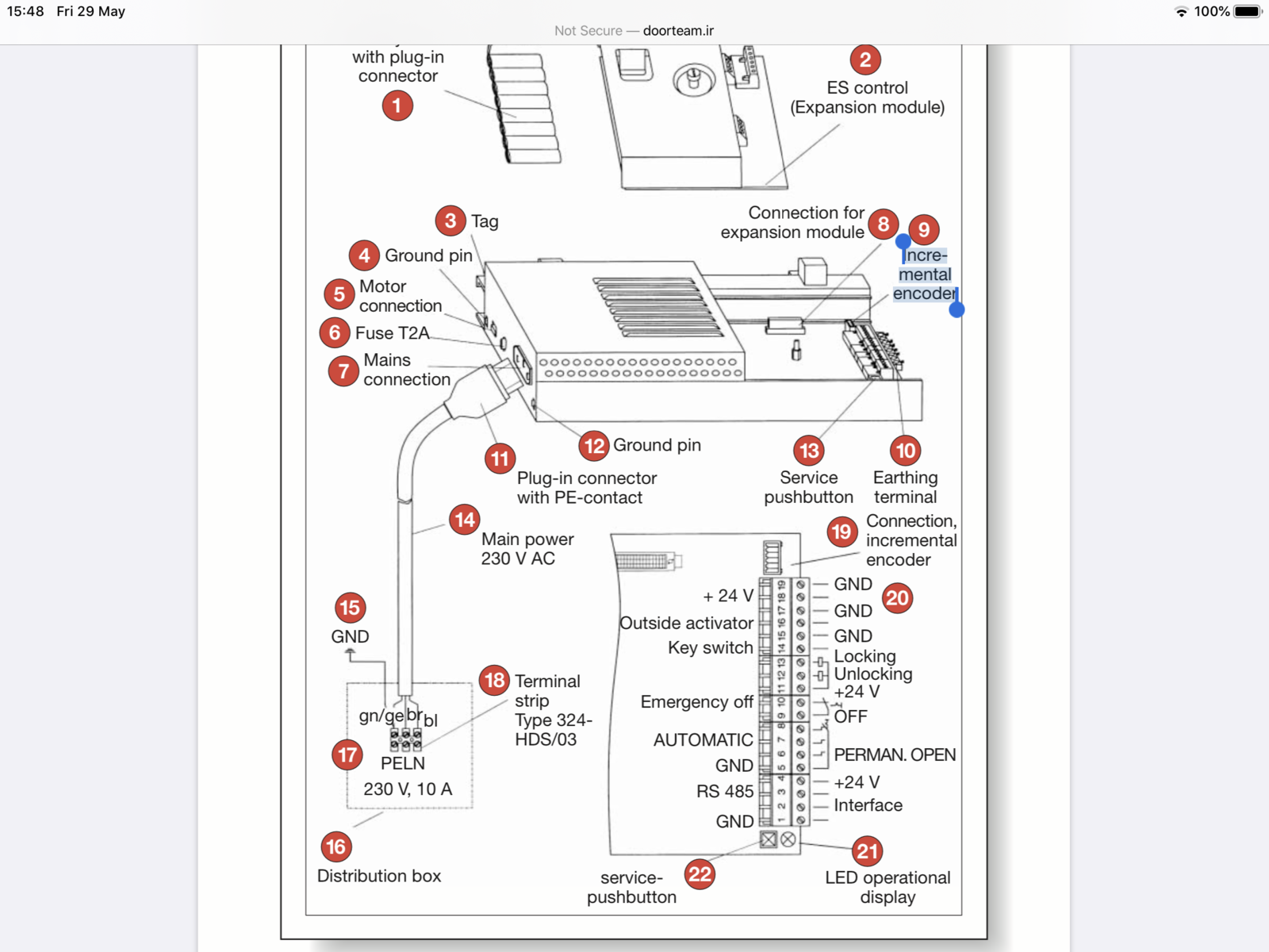

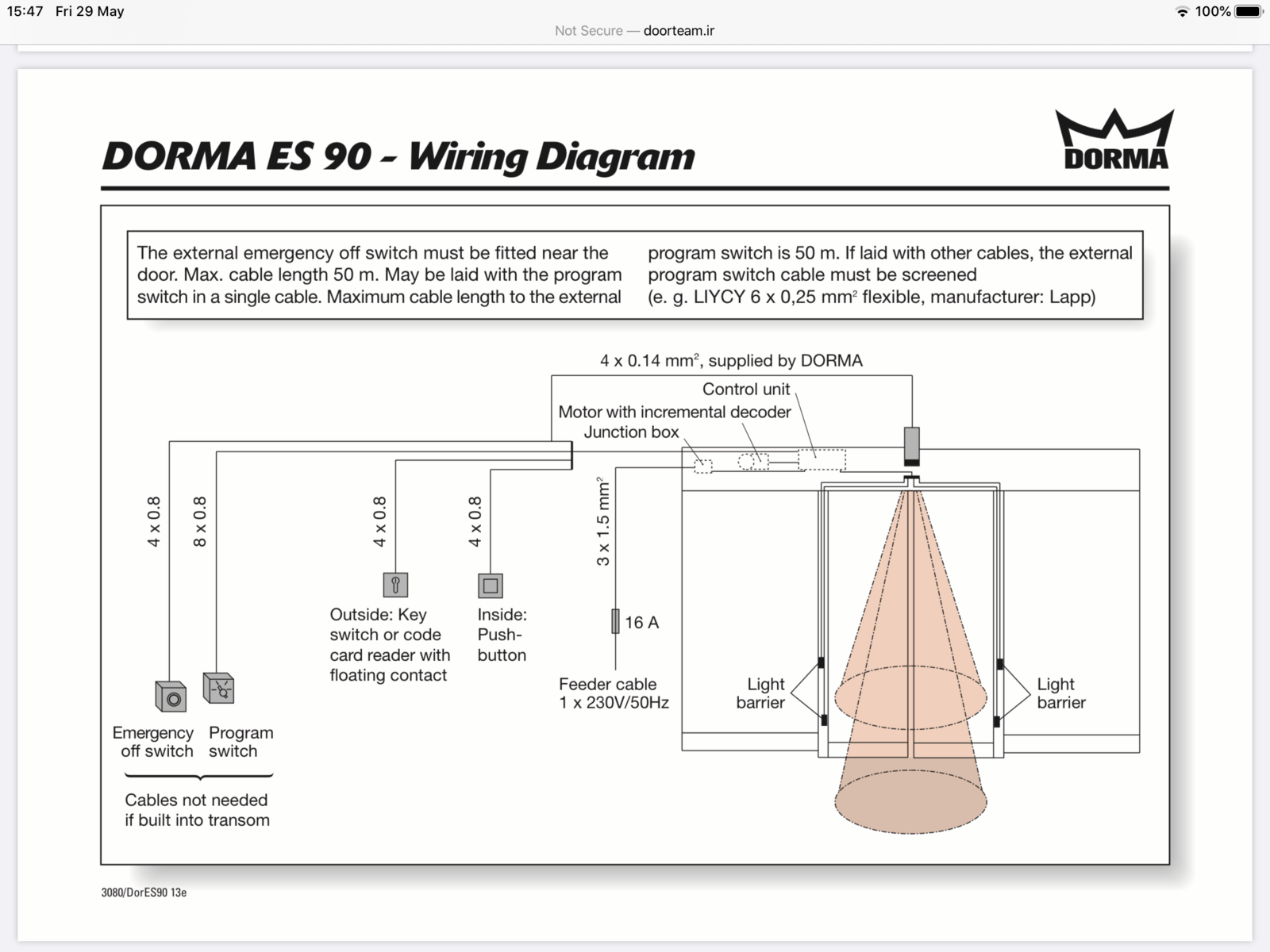

Thanks sparkymarka... there is some stuff around.... there is a daughter board (the EM4) which I'm struggling to find the connection details for. In particular how to identify the light beam connections & which is the TX & which is the receive (somebody else has disconnected the wiring.... and now it falls to me to put it back together!)
