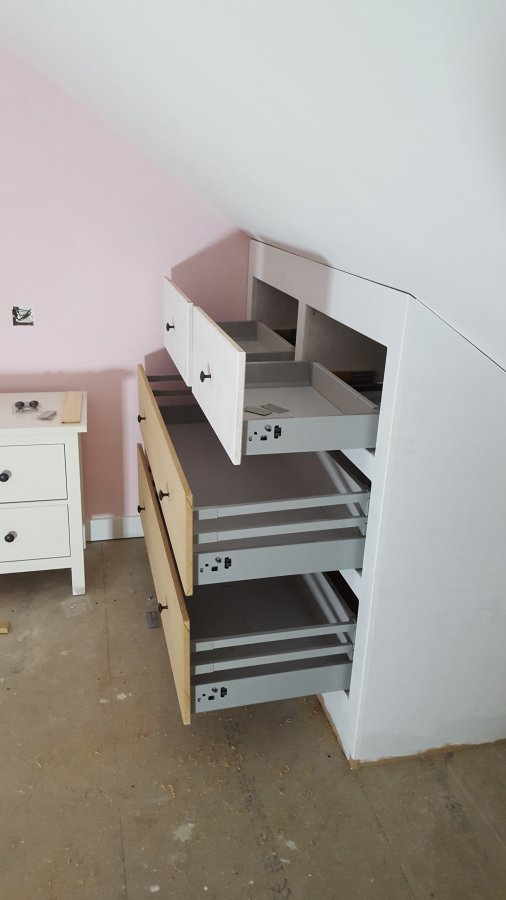

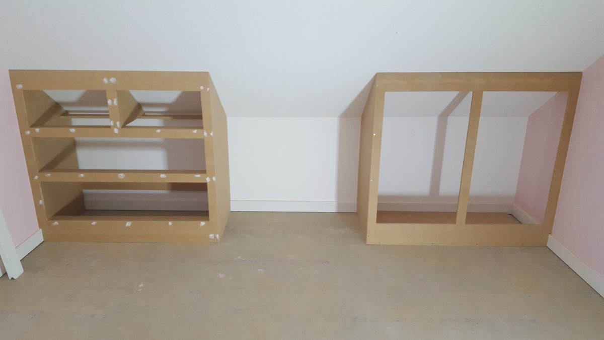

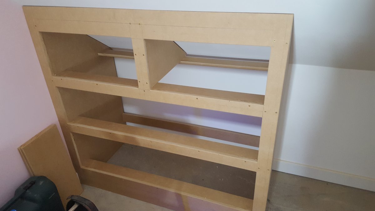

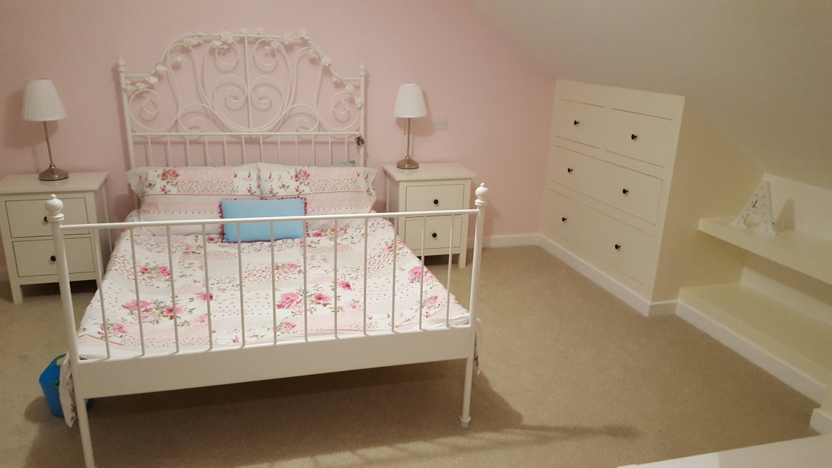

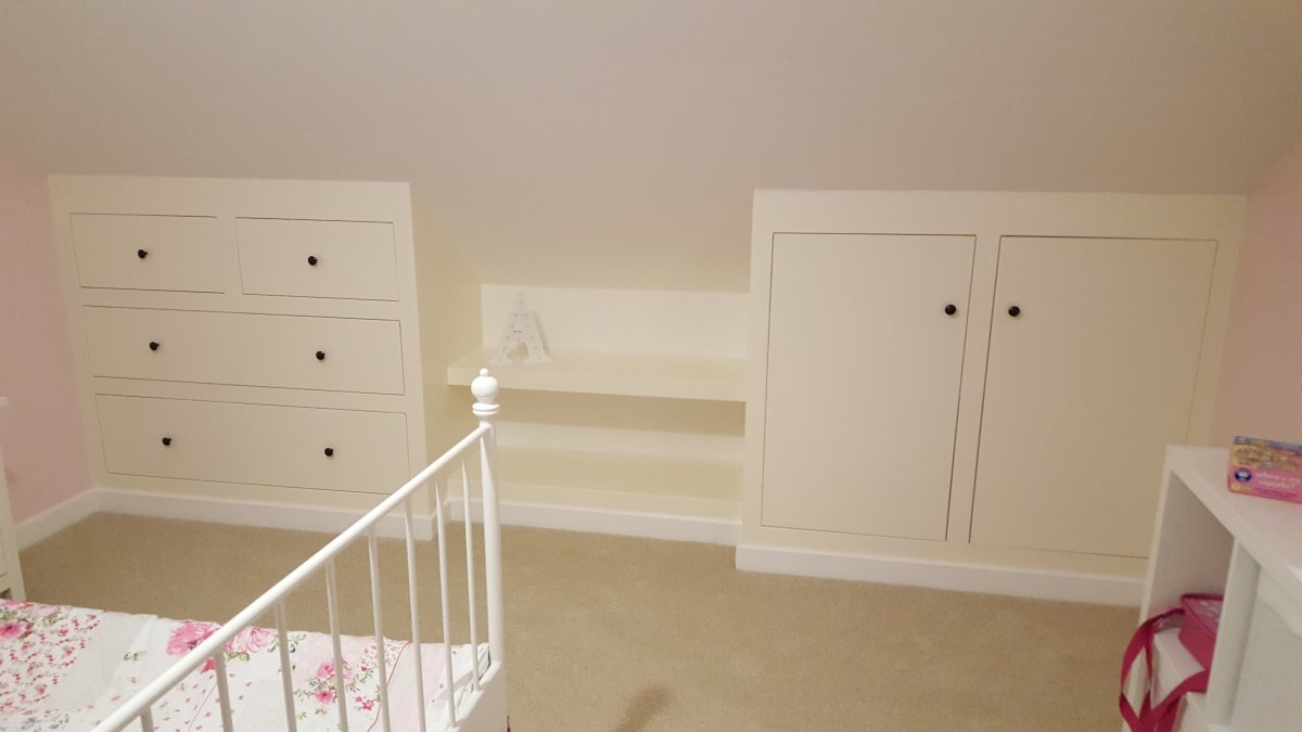

Here are some photos of some units i built last week to match the other bedroom units.
thanks. they did turn out verry nice tbh and verry pleased with them.
Looks great. What are the actual drawer parts? is that some kind of off the shelf kit where you just add your own drawer front? If so, I didn't realise you can get whole drawers and was about to build my own and buy runners. But that looks more professional and will save me some hassle.
hi. yes you can put your own facing on them. there baisicly like kitchen drawrs with soft close runners. i bought two pairs of the deep ones and two shallow ones. you then make the bottom and back piece out of 19mm laminate. you have up, down, left and right adjustment. verry handy when you only have mm either side. ill find the link for you.
