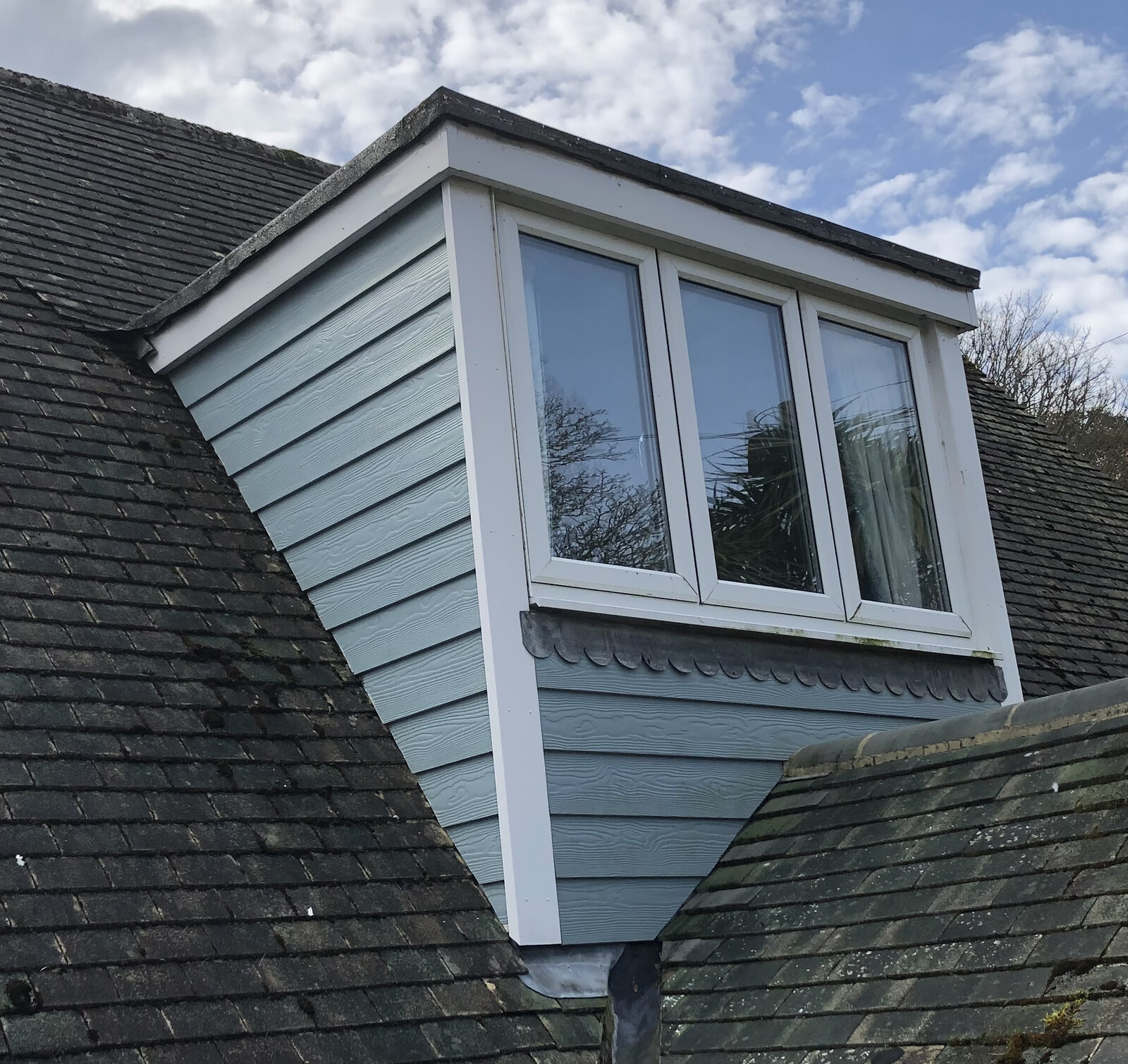

On my small 1960's Dormer, we removed Tiles then we decided to keep it simple and filled the void in the Studding with Celotex, then OSB, followed by a DPM/Vapour Barrier, then vertical battens and then finished with Marley Boards. We could have re-fitted horizontal battens and Tiles but prefer the look of the Marley Boards.
