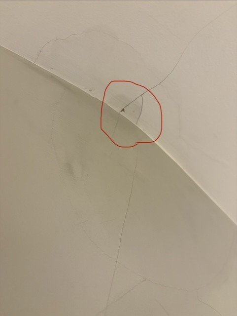

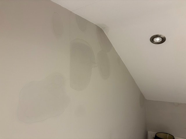

We had a dormer loft conversion on a Victorian semi done back in 2018/19. Since then we have had issues with damp/wet patches on the chimney breast wall - see attached photo.
We have now had a roofer re-flaunch the chimney, secure the pots and undertake work on the ridge where the flat roof dormer meets the chimney breast. This has resolved many of the issues - 99% of the marks in the photo are now no longer becoming wet during heavy rain (obviously they need sealing/redecorating). In short, we thought the issue had been resolved!

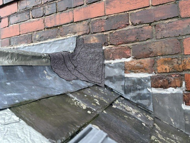

Unfortunately recent rain has seen a very small wet patch reappear - circled in red on one of the photos. It is very small, about 1-2cm in diameter. I also attach a photo of the external patch job/works. This patch falls directly underneath where the ridge falls into the pitched/slate roof, where felt has been torched on (over existing lead/step flashing an soakers).
I would welcome any advice as to what action we should now take to resolve this issue as we just can't seem to fully solve it (although most of issue has now been resolved). Thoughts gratefully welcome!!

Felt dressed up the wall isn't the best , should really be done in lead chased into the brickwork.
Looks like you have flashband along the edge, would only consider that as a temporary measure.
Think you may be in need of a competent roofer

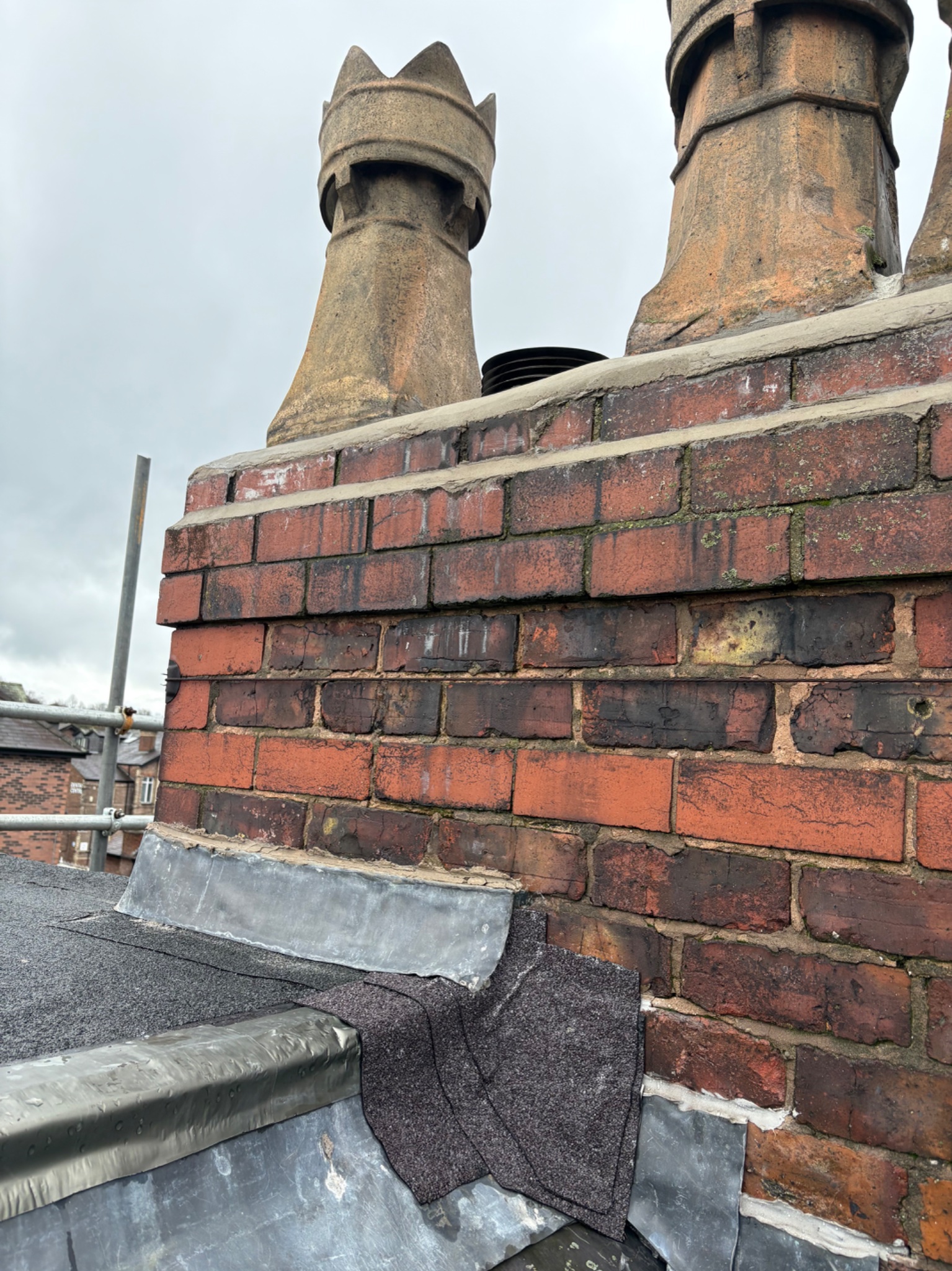

Pics with a wider context, and a pic showing the flaunching might help?
Remove the old TV aerial if its redundant.
Have the chimney flues been swept and vented?
Whats the purpose of the scaffold?

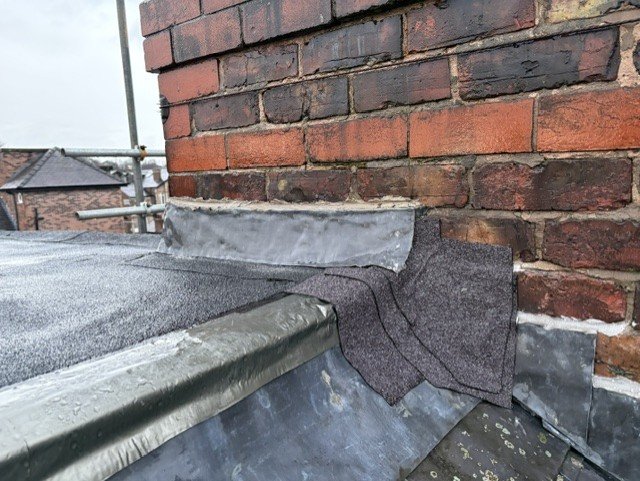

Here is wider photo. Just had chimney re-flaunched.
Would welcome any other thoughts and observations.

Scaffolding is currently up cos work is being done to roof…but cannot seem to solve this particular issue!

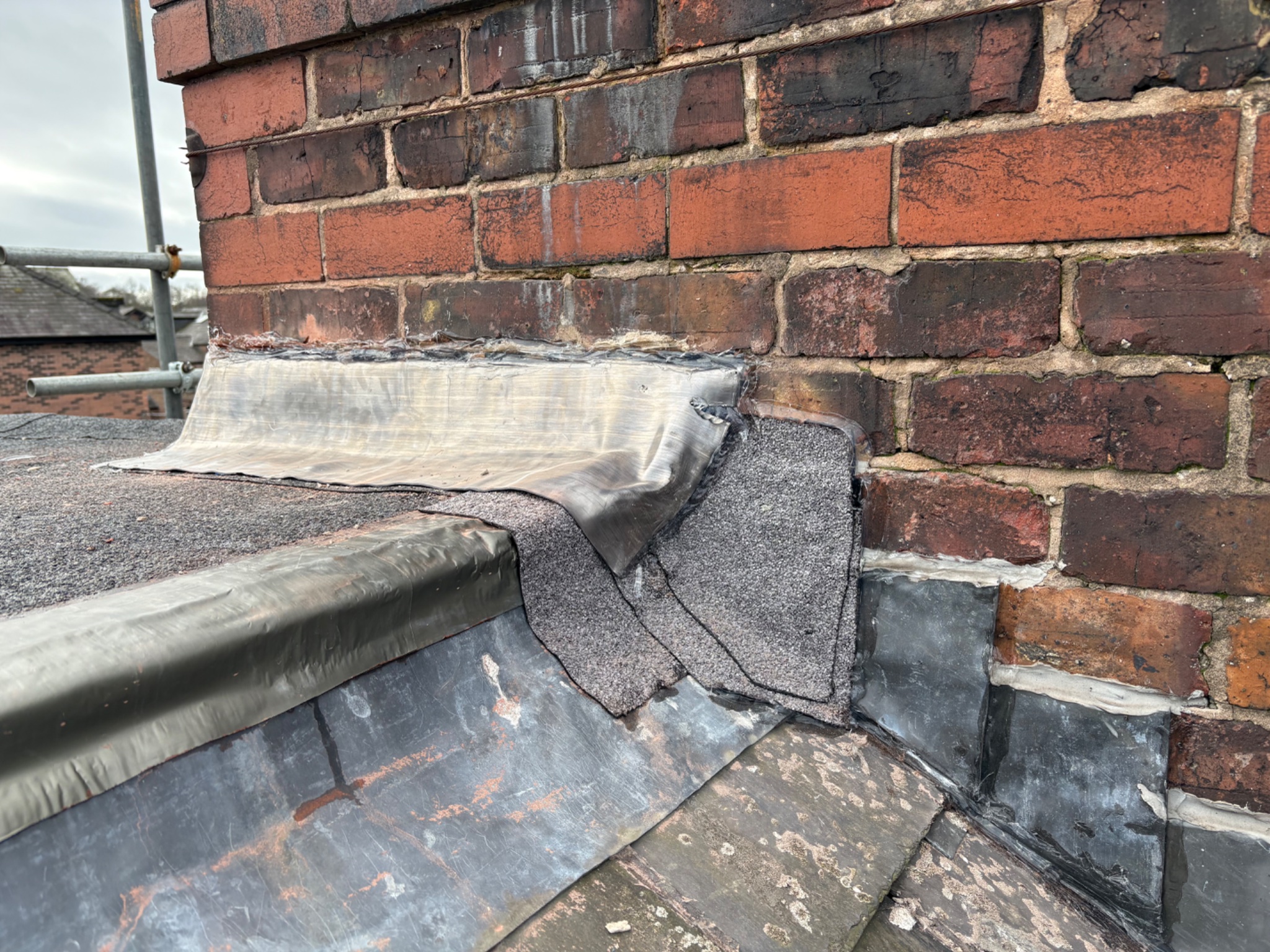

This issue is still causing us internal leaks. I gave the roofer the opportunity to come back and resolve the issue and this was what he did.
Damps patches are still penetrating into the dormer bedroom wall at this point.
I would welcome any advice as to the best way of resolving this, specially what I should request the roofer to do under the 12 month warranty.

You certainly need to make a request of the roofer. Basically to never venture within a mile of your property ever again. What a horrible sight. You need to get an actual roofer to rip all that up and do the job properly.
Lost count of how many times I have seen this! Always a mistake to incorporate an old chimney into a loft conversion.
Ideally, you need to dry-line that area, so those minor dribbles don't interfere with your internal decor.
Some roaring fires will also keep the damp at bay!
That flat roof is sealed with flashband where it meets the pitched roof. Terrible detail that will fail within a few years.
The leak is indicative of defective flashing, poor pointing or less likely but possible, lack of DPC around the stack.
Have the flashing done properly and the stack repointed. Also ensure the chimney capping and flaunching is in good condition, else rectify that to.
That tends to sort these problems out. But "properly" is the key word.
