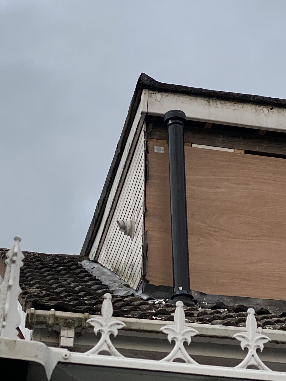

Hi everyone
Currently refitting the facing of a dormer. It was a cowboy job 20 years ago but in fairness has just about lasted. I’ve ripped the previous sheathing off which was plasterboard…it’s being replaced with ply. The plan was as follows:
Ply
Breathable membrane (tyvek housewrap)
Battens
Upvc cladding.
However, I’ve just realised that the existing one didn’t have battens and so if I were to use them the facing would stick out past the fascia boards. I really don’t want to mess with those as it means redoing the roof, or at least the edges?
How essential is it to have the battens. Appreciate they allow the ply to breathe but if a breather membrane is on is that not enough? What are my options here?
Attached a pic of it helps.
Thanks all!

Thanks. I think the issue I’ll have is that it’ll stick out past the fascia on the sides. So I’m not sure how to compensate for that. The fascia needs to overhang the cladding slightly doesn’t it?
Over that small area IMHO even a 5mm space between the membrane and the back of the cladding should be enough. As long as that space has a gap top and bottom any condensation will still evaporate.

Progress update. Got the front face on. Will weather proof it tomorrow before the rain.

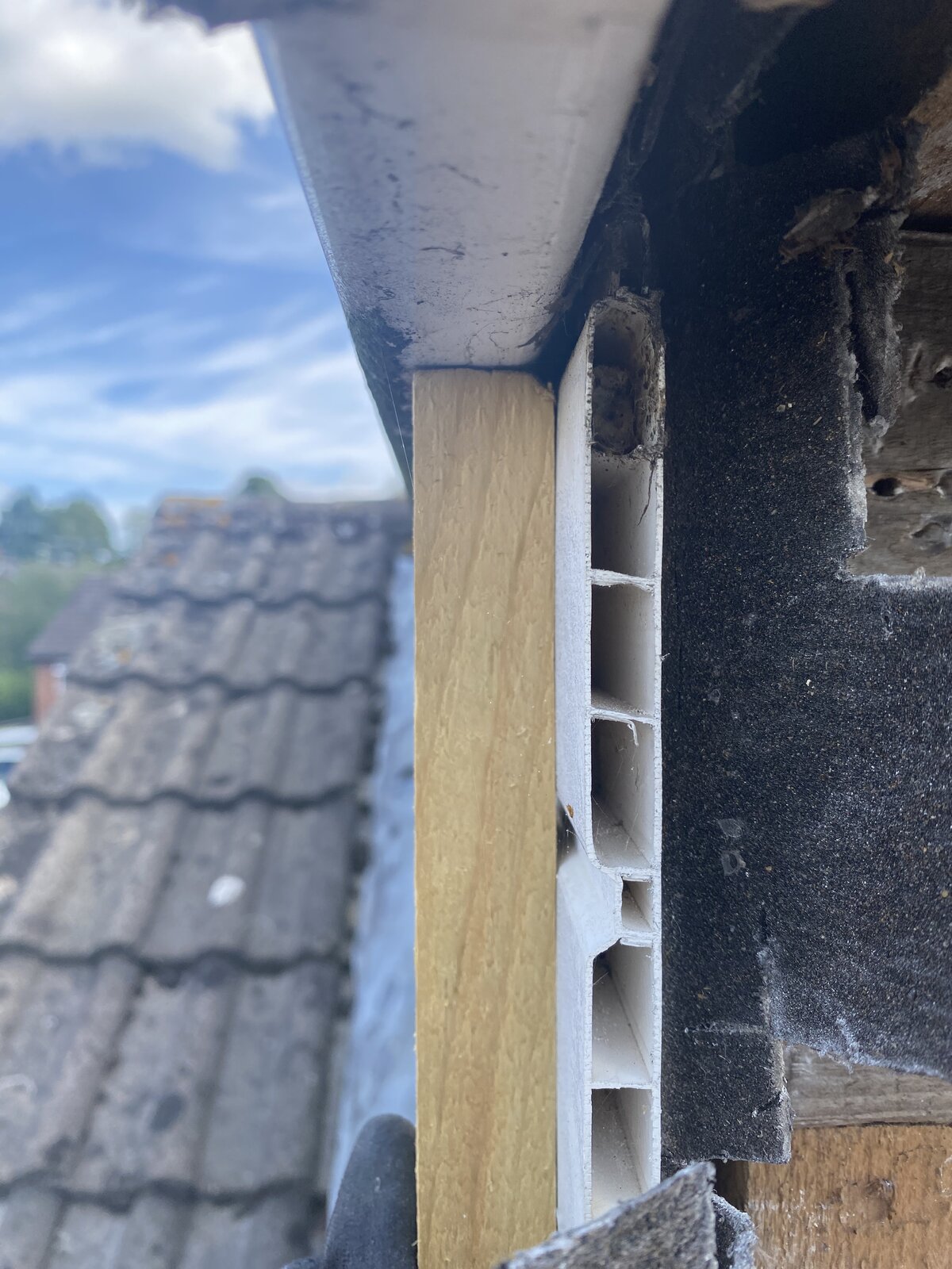

I was thinking about the battens and wondering if ply would be good? I’m going to have some spare so could run some 50mm wide strips off for it? It’s 12mm thick so would give enough of a gap I think? The picture from the side is with a 25mm batten under it. It’s got the old cladding on that part still so it would end roughly there under the fascia.

Hi all, any recommendation on if ply would work for the battens or is it likely to fall apart?

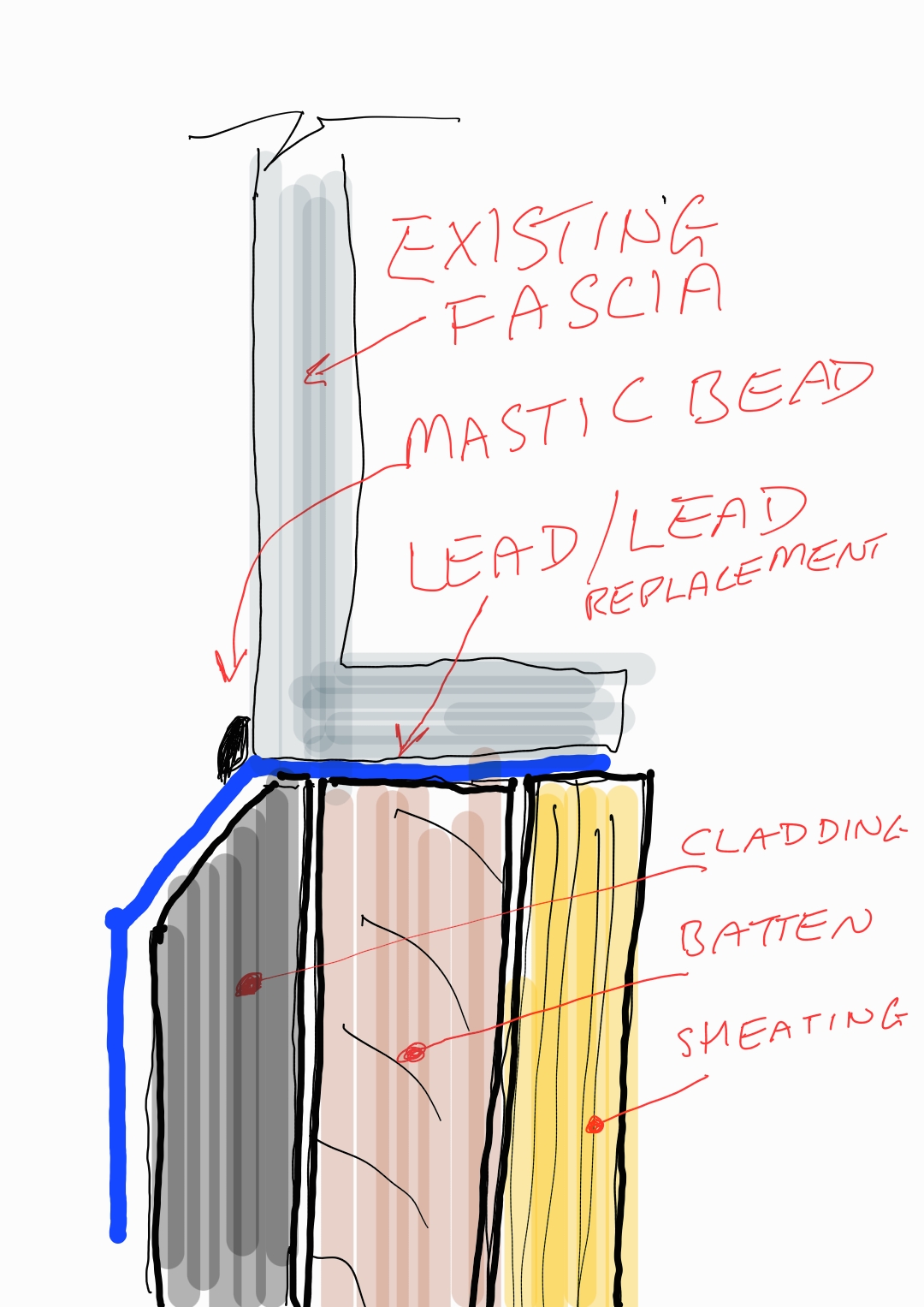

One option for dealing with the projection is
It could also be designed with a ventilation strip.
Ply battens could work, but there is a risk of them delaminating over time due to exposure to potentially moist air. Long fixings through into the frame may counter this.
If you are not venting the cavity top and bottom, then you don't need to worry about the batten thickness as you are then just reliant on luck. In this case, internal vapour barrier detailing and quality of installing becomes much more important.

The image demonstrates the principle of covering cladding that projects further then the fascia. The cladding could be another 50mm out, but the principle remains the same.
Venting top and bottom of cladding involves either fitting proprietary vent strips or fitting stainless steel mesh. The top needs to be covered to prevent rain ingress, and the bottom needs to be detailed along with some flashing to prevent ingress to the frame and to let any moisture drain out to the roof surface. It needs care to detail. Have a google, or I'll see if I have some details on the principle.
