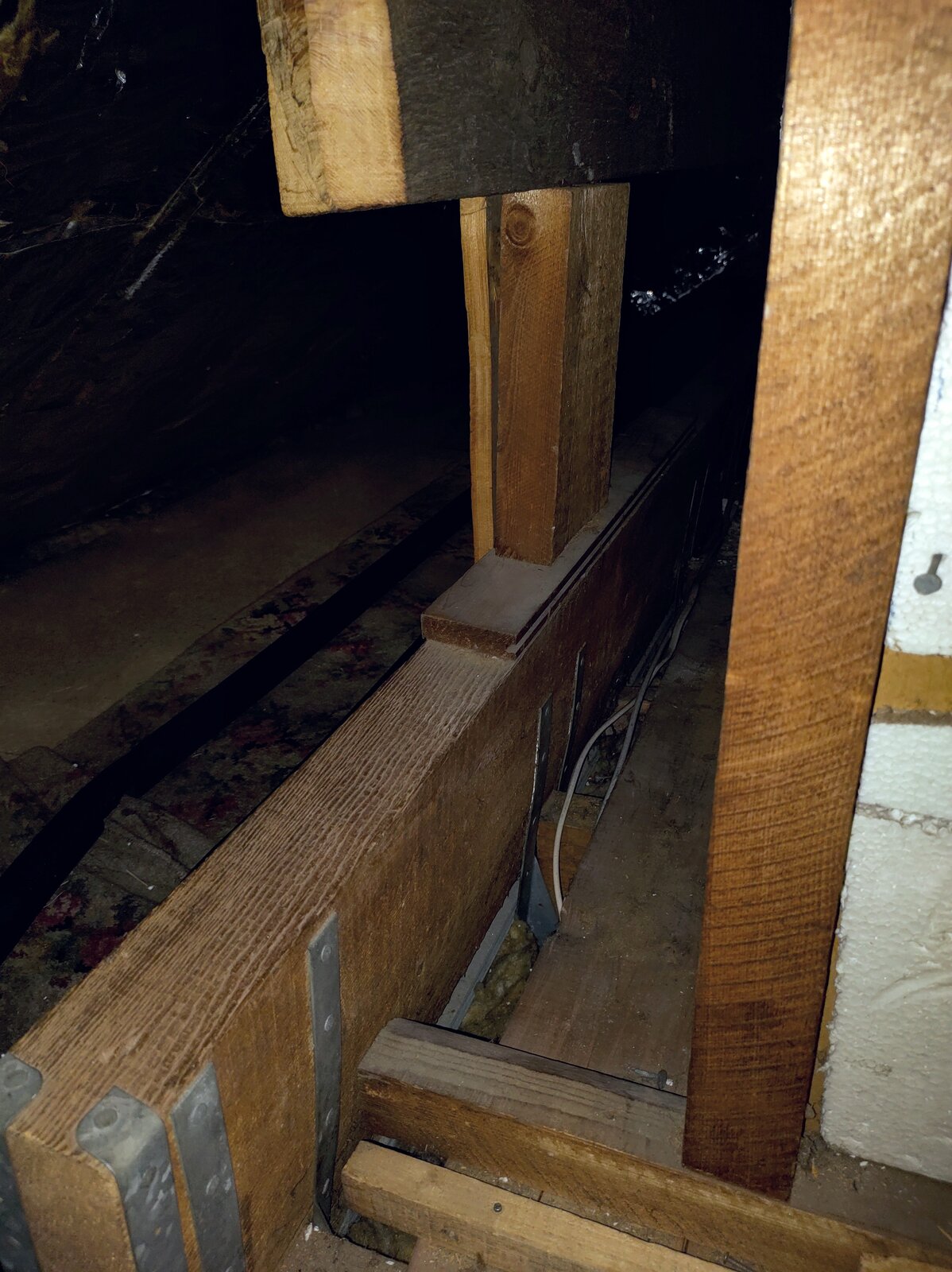

The estate agent wouldn't provide a copy of the report, fair enough, I had a garbled conversation with them and the apparent issue is the two main timber beams that carry the loft floor joists. His concern is that they may deflect excessively (not that they have done yet) and that one of them has rotated.
Looking at the rear dormer first, the beam picks up the loft floor joists via hangers and is below and slightly offset from the original purlin, at the far end it's carried off the party wall via a heavy duty joist hangar, at the near end it bears on a masonry wall, the original purlin carries the front face of the dormer and loads pretty much down to the same place as the new beam, the cheeks of all the dormers are built off the new loft floors/joists.
The photo shows near end of new beam and existing purlin:

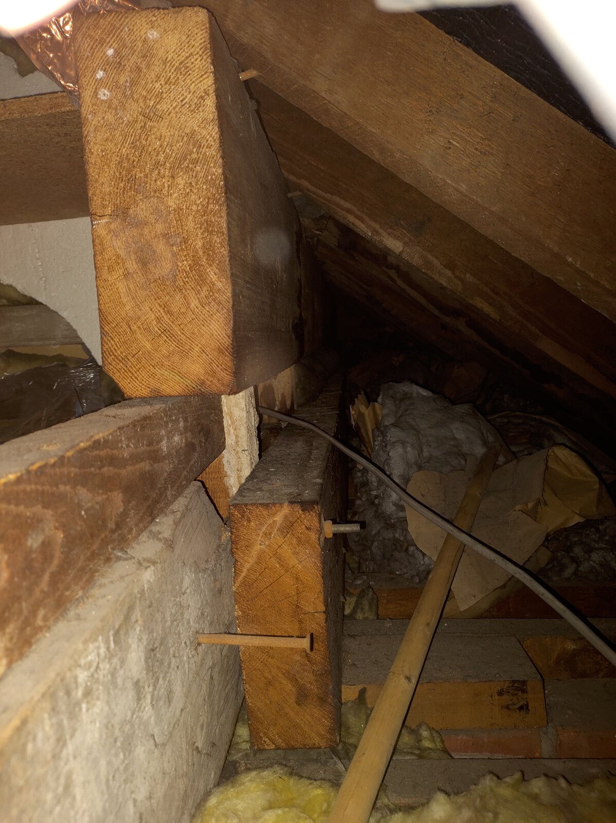

The front dormer is similar but with some distance between purlin and beam, however this one looks a bit more ropey at the near end (hence his comment about rotation).
This is the front dormer beam and purlin with connecting prop (just above the bearing wall below - I presume the original brick pier or purlin prop was removed at the time)

I can see virtually no deflection of the purlins or new beams - but obviously don't know whether they are potentially overloaded. I can see that the twisted purlin and beam arrangement might be an issue but that it could probably be restrained by something a bit more substantial than that piece of floorboard - I'll probably do something with that regardless.
Any thoughts would be appreciated - if something looks seriously wrong and is going to be flagged up again we might be better getting a report and a bit of remedial work, otherwise we'll just take our chances.

Nice bit of balancing going on there. I'd just beef it up with some decent timber and good screw fixings. It's been there all those years without going anywhere so you really just need to stabilise the balancing trick and make it look better.
As Jeds really
Find a beefier bit of timber and wind it up with a car jack of something and make good.

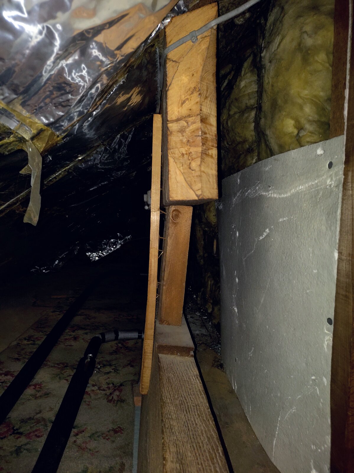

I've managed to straighten up the beam with some timber, bolts and steel plates, looks a lot better:
after:
I'm still not sure about the beams carrying the floors so I'm still tempted to bolt some steel flitch plates on them?
You are better off fixing something in front of that so that whoever next pokes their head through the hatch, sees nothing or something that looks less Heath-Robinson
