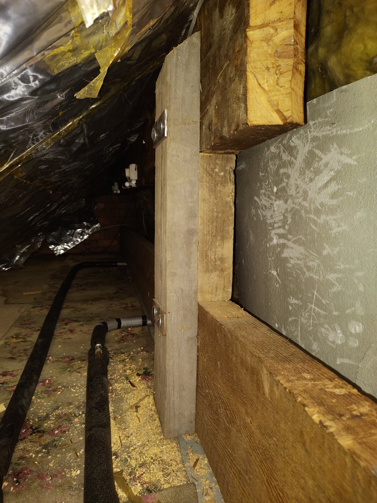

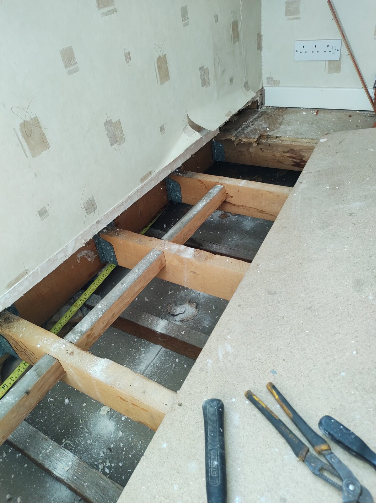

They're very protective of their report but read some bits out - the Chartered Surveyor (apparently with 40 years experience) is adamant that the beams supporting the floor are sitting on the original ceiling joists - and their deflection has caused cracking of the plasterboard joints in the ceilings below. Personally I think they should ask for their money back, I can get my fingers under that beam:
However, I can't argue that the beam isn't slightly inadequate and I can see a bit of floor dip across the spans so I'm going to flitch the two beams.

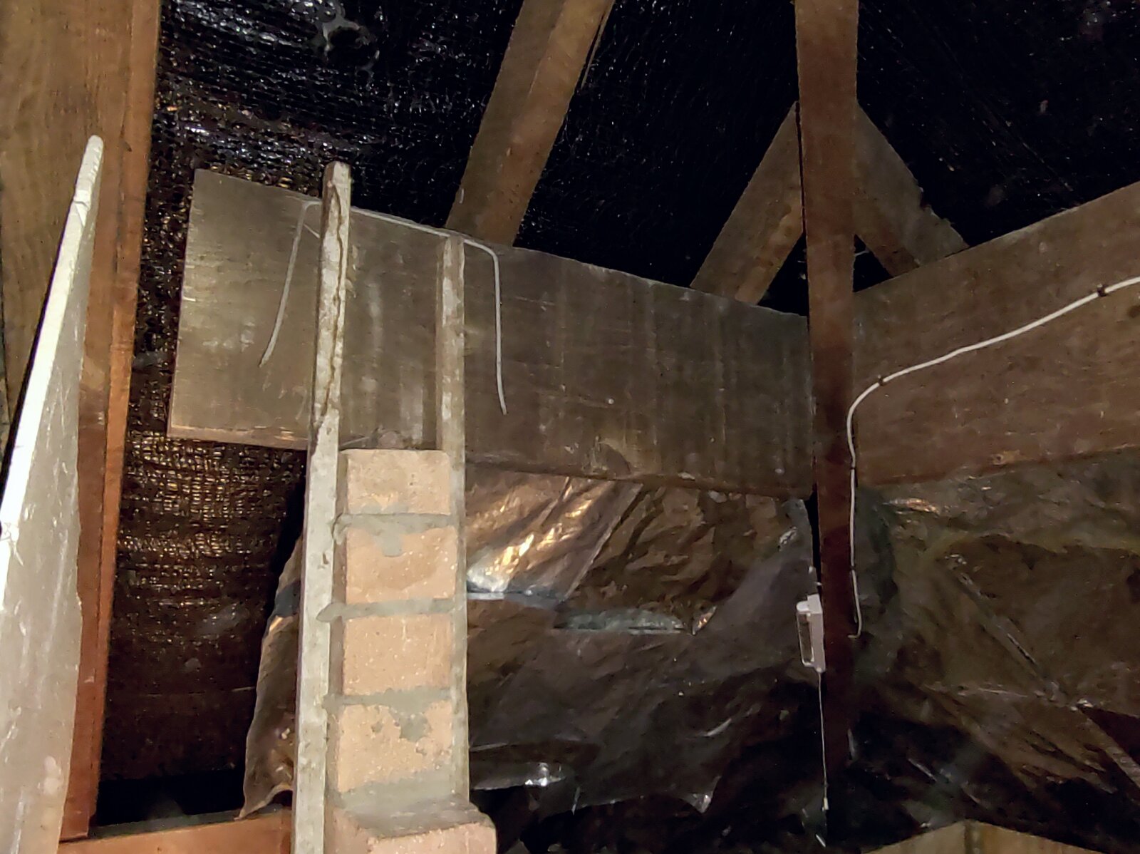

The other mentions were deflection of the hip blade - presumably due cut off purlin which I presume would have originally cantilevered over the pier and supported it?
I'm guessing this isn't acceptable? I could span two wall below with a 3m steel and prop the end of this up.

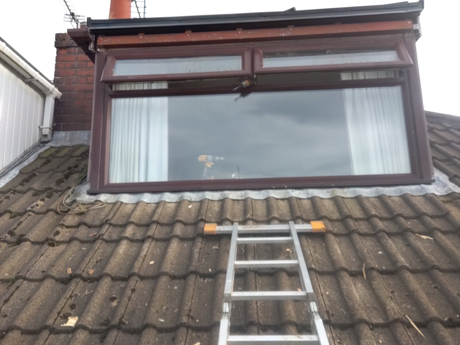

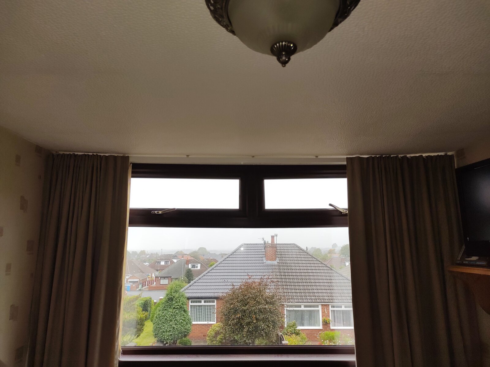

The other thing was deflection of the roof of the rear dormer -

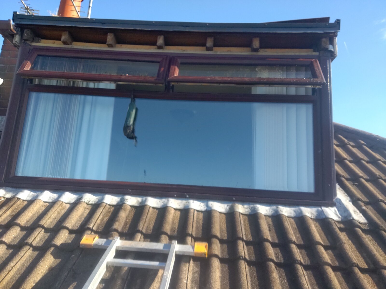

This is nearly 25mm mid (2.4m span), obviously not helped by the plastic windows - I think I can get the fascia board off, jack it up and strengthen with some angle iron.
I've told the buyers I'd flitch the beams, I'm also going to do the dormer roof and unless anyone thinks it's not necessary, prop the purlin/hip blade.
They have agreed to pay for a structural engineer to inspect afterwards which will hopefully have a more positive outcome.

A bit straighter now:
The angle iron has deflected a little bit more than I would have liked but it was what I had to hand that I could manage off a ladder. I was able to trim the piece of timber between frame and joists to allow the frame to be pulled up perfectly level.
