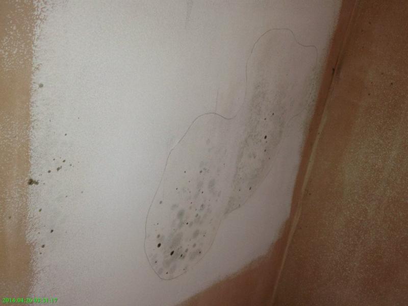

I hate to put a dampner (no pun) on things, but i fear your situation will simply not get any better.
Take a look at what some cowboys did to our wall with dotting & dabbing on a damp wall when they guaranteed this would NOT happen...
We used to have a damp wall. Now we have a damp wall with mould & it gets worse by the day.
I hope your situation wont turn out as bad but just google "dot & dab on damp wall". I warn you - prepare yourself.
Solution for us? £1,660 worth of plaster has to be removed & start again.

Thought I would let you know how I got on seen as you were all kind enough to have some input. About a week ago I gave the patches a good coat of 'ronseal one coat damp seal' when that had dried I when back over with the original paint emulsion. Job seems to be a gooden - can't see the patches and I hope it stays that way! Cheers.
Make sure you keep the room well ventilated as those spots will be colder than other areas in the winter and would be a magnet for condensation which could then form mould.
No amount of damp seal will fix that as the moisture would be coming from the inside.
Thanks for the advice. It's in the main bedroom and luckily I like the window being open blowing in with fresh air. I accept it's not an ideal or perminant fix but fingers crossed will be ok for a whole.
