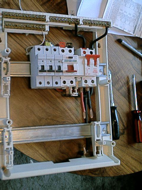

I had something similar.
There was a Main Switch, which fed a RCD on the same row, and had two fixed, solid copper, insulated links to the RCD in the other row.
I called it a double-decker.
I have some photos somewhere.

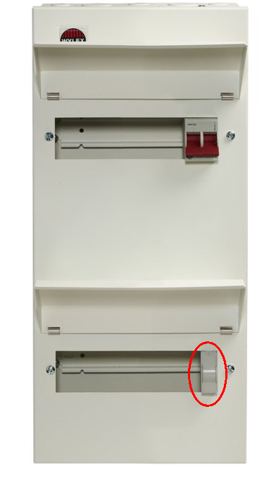

Sorry, I can't see what you are referring me to. That link takes me to an image of the CU. I can't see the internals.
You don't need to see the internals. I presume that flameport was referring to the item I have highlighted here - a 'straight-through' connector to the L busbar of the lower row - so analogous to a single-pole main-switch which is 'always on'.

I would imagine that many would say that the sort of approach flameport mentioned, and which I illustrated in the previous post, would (when available for the board in question) be the 'best practice', wouldn't they?

I would imagine that is what most people would do - which is not materially different from how the second RCD is often fed in (single row) dual-RCD board. Products such as flameport has mentioned are designed to avoid having to but a cable, as well as the busbar lug, into one terminal of a device - but, as I've just said, that is something which is very often done - even with 'factory-installed' connections.
