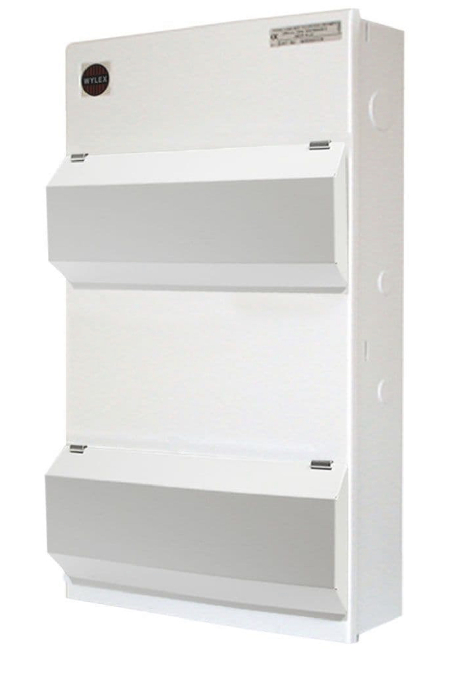

My consumer unit is similar to this:
This is what I mean by RCBO’s across the two rows.
How should the busbar provide a continuous link between these two rows and ultimately back to the main switch?

Isn’t the image I posted known as a “double bank board”?
Since it currently has two RCD’s to protect the MCB’s, isn’t that the “Dual RCD” aspect of it?
If this is an existing DB both rows are presumably powered already? picture(s) would help
Dual RCD could also describe a board with a straight run of devices with two RCDs.
But as the title says double bank, I assumed it was one row on top of the other.
Stacked, some people call it.
Ok. My mistake. I think.
More commonly "stacked" - but, yes, that's what I took you to mean
Yes, as it has a total of two RCDs, that makes it "dual RCD" in my book. However, as has been said, the two 'rows' must already be 'powered'.
Is you problem perhaps that one (probably both) of the rows is currently powered 'through an RCD' in that row (i.e. that row effectively has an 'RCD incomer') whereas, for all RCBOs, you want both rows to be powered by a direct connection to their busbars?
