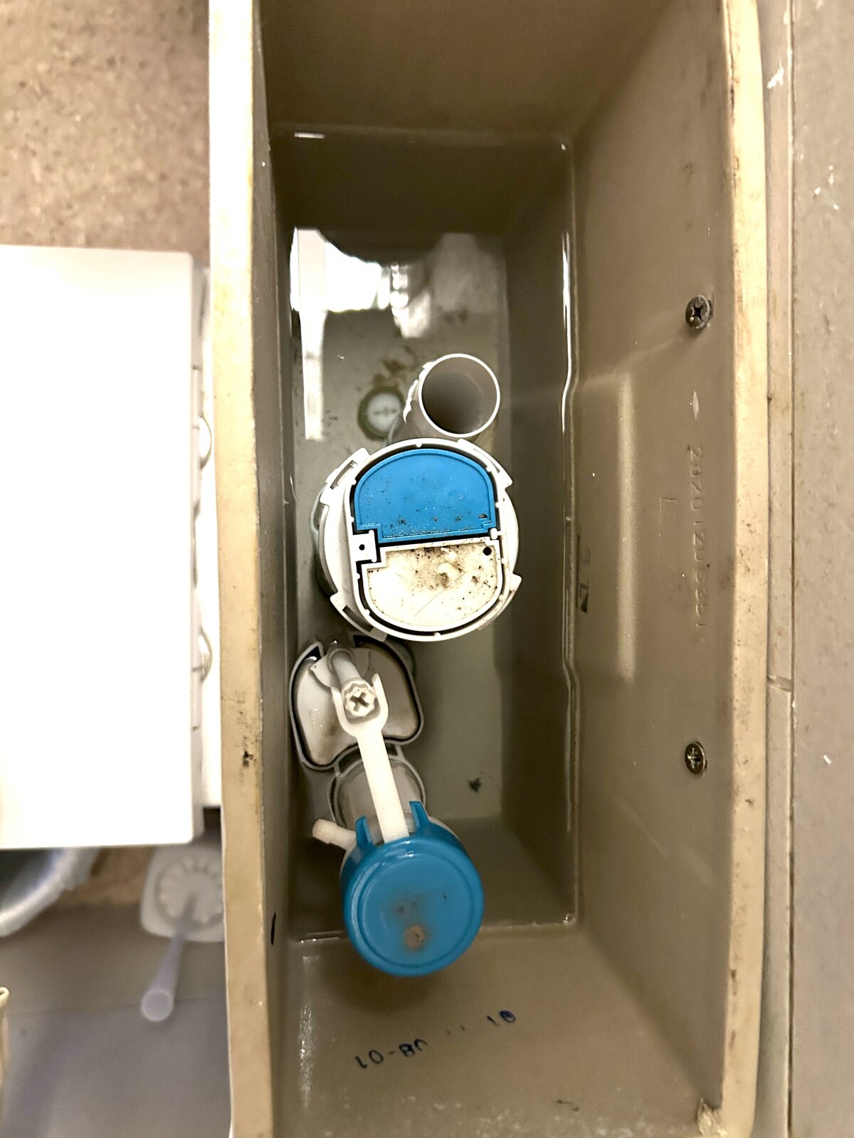

I need to replace the washer on my WC double flush valve.
As you can see I have removed the cartridge successfully

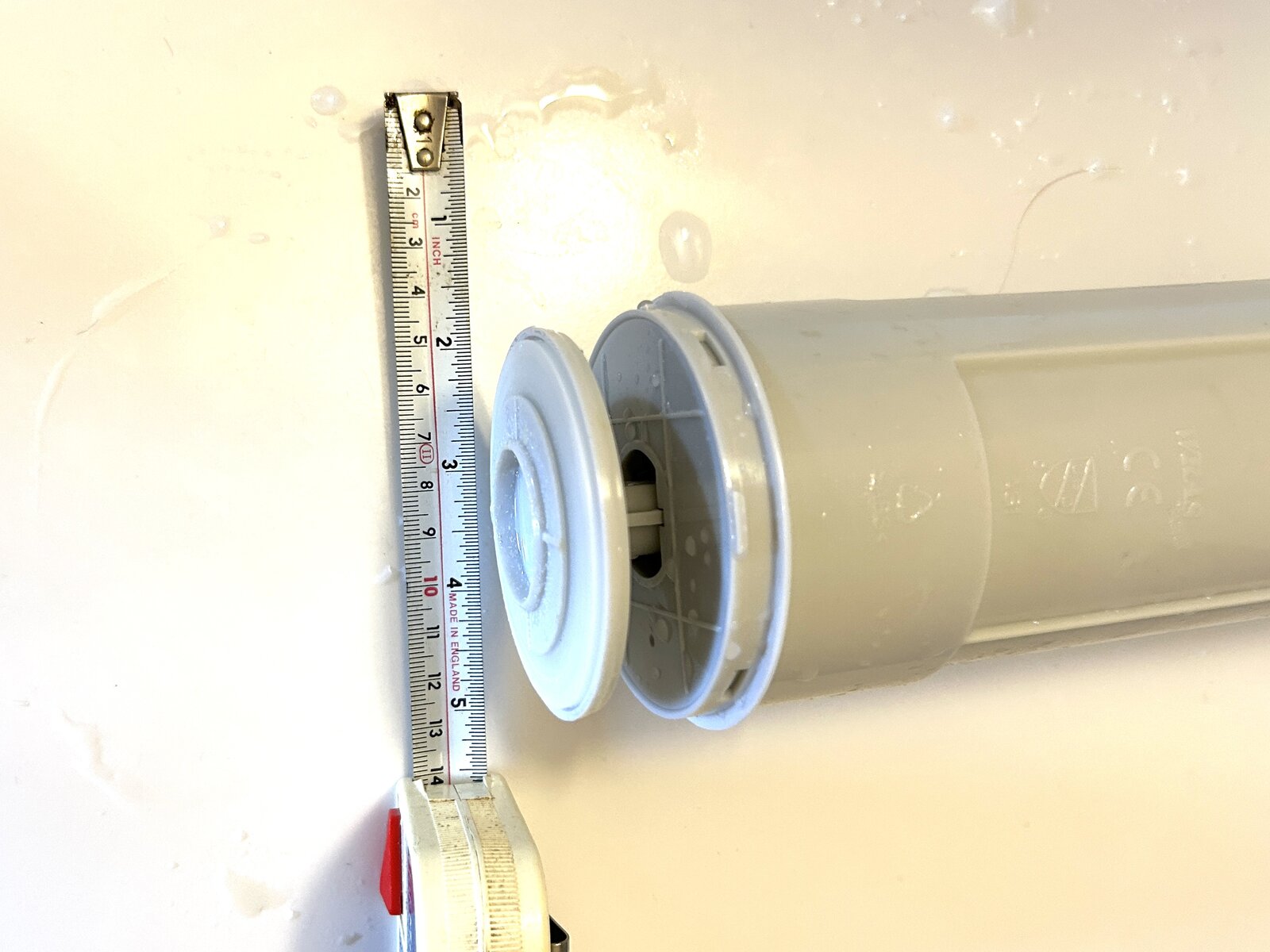

I’ve look carefully but it’s not marked with the name of the manufacturer so I don’t know who to contact to order the correct replacement washer.

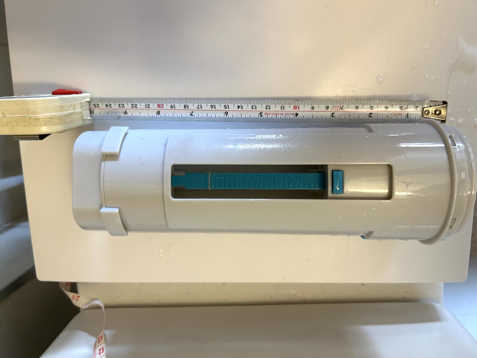

The OD of the washer is about 3”.

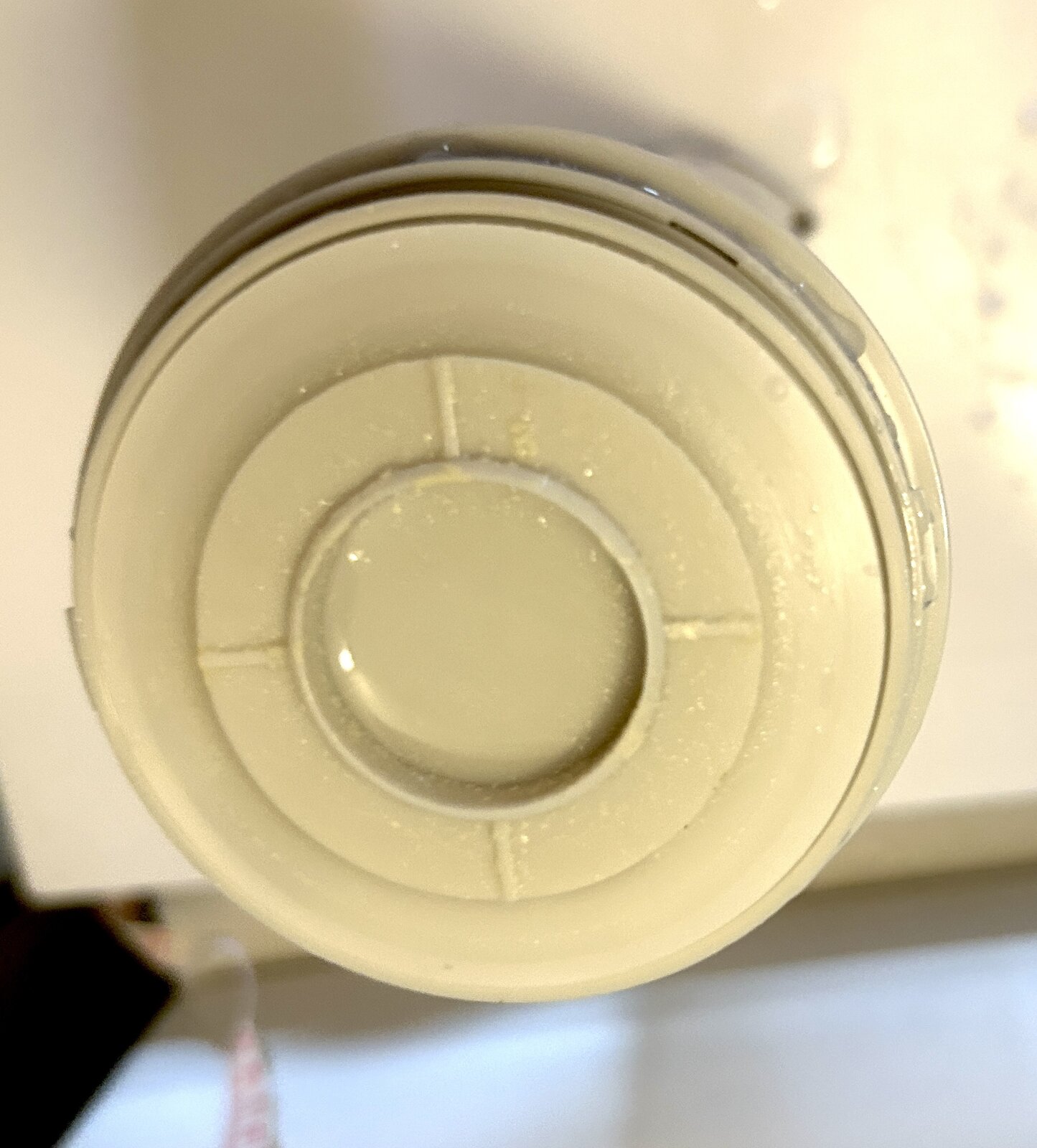

Also I wonder what the procedure is to replace the washer.
Does it unscrew?
Do you prise it off somewhat like a bike road tyre?
It should be softish/pliable rubber/silicone. It will pull off the plastic part.
Then you can measure/compare with the selection from one supplier, above. There are other suppliers.
It's possible someone can confirm the make - but there's a few out there that look similar.
