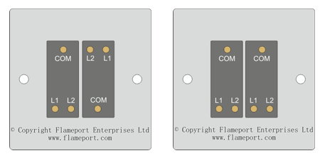

In each switch:
Red in Com
Black in L1
If the switch works 'upside down' then put the black in L2
Switches vary - but the terminals are in a triangle:
These triangles may be the same way up as your present one is or
one of them may be upside down.
Thanks to Flameport for the picture.
Com, L1, L2 responds to
L,..... L1, L2 or
L1,... L2, L3.
depending on the make.
