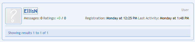

Yeah. There's a new member been spending today resurrecting any old thread relating to lighting. One hopes this is not a prelude to lighting spam. I thought that there was a warning came up about necro-posting?
OOPs, I posted then saw how old it was, sorry and thanks for the reprimand DetlefSchmitz (I am not a new member though)
Every one of his posts has been taken down:
