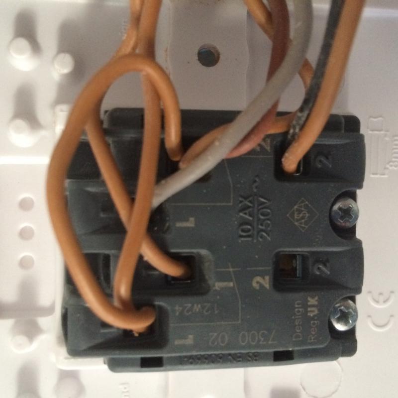

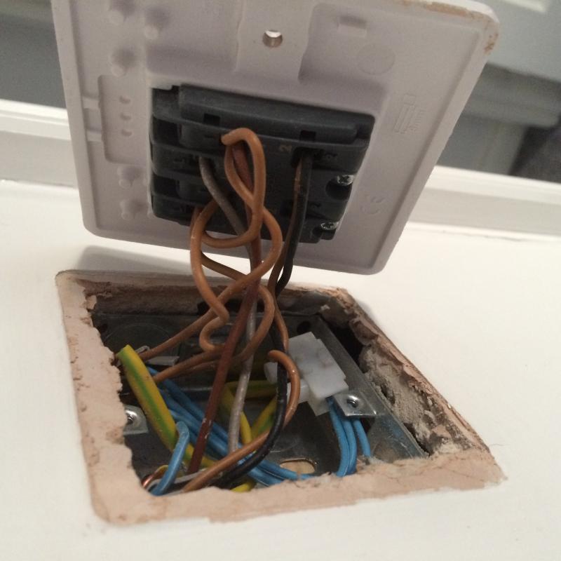

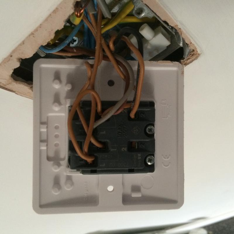

I have opened up and looed at the wiring and I'm baffled! There is another switch on the other side of the room which also operates one of the ceiling lights.
Can you help ! I've attached Pictures.. please try and speak in layman terms ! ha ha..

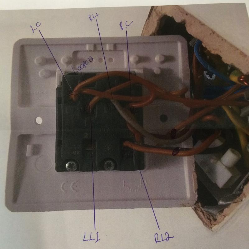

I think I've worked it out ?? Can someone just tell me if I'll blow up!
LL1 is left side and RL1 is right side obviously [net]
222610/83715_53517542.jpg[/net]
If you simply transfer the conductors to the new switch:
L -> C
1 -> L1
2 -> L2
then it will work as it currently does.
It is very important that you label the conductors before you remove them - if you lose track of what goes where you will be in a world of pain from which will take a lot of effort to extricate yourself.

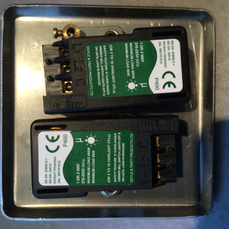

1) I think it will be a real struggle, possibly an impossible one, to get that dimmer switch to fit - a deeper back-box may well be required.
2) Are you aware that if you have a dimmer there, then when you turn the lights on at the other location, they will come on at whatever brightness the dimmer is set to, and you'll have to walk over to it to adjust it if it's not right?
If you want to control the dimming from both locations you'll need a different sort of dimmer, one which comes as a master-slave pair. They are wired differently, so you'd need to pay close attention to make sure you identify which conductor is which in the cables linking the two switches.

4) The wiring looks odd for both gangs to work as 2-way, one of them has no conductors in L2:
Do they all work properly?
Thanks BAS.
Only one of the gangs is 2 way hence nothing in L2 ..

Bear in mind that the dimmer will almost certainly not work with energy saving lamps, unless you have bought special lamps and special dimmers designed to work together.
I see your dimmer is labelled to work with Varilight CFLs

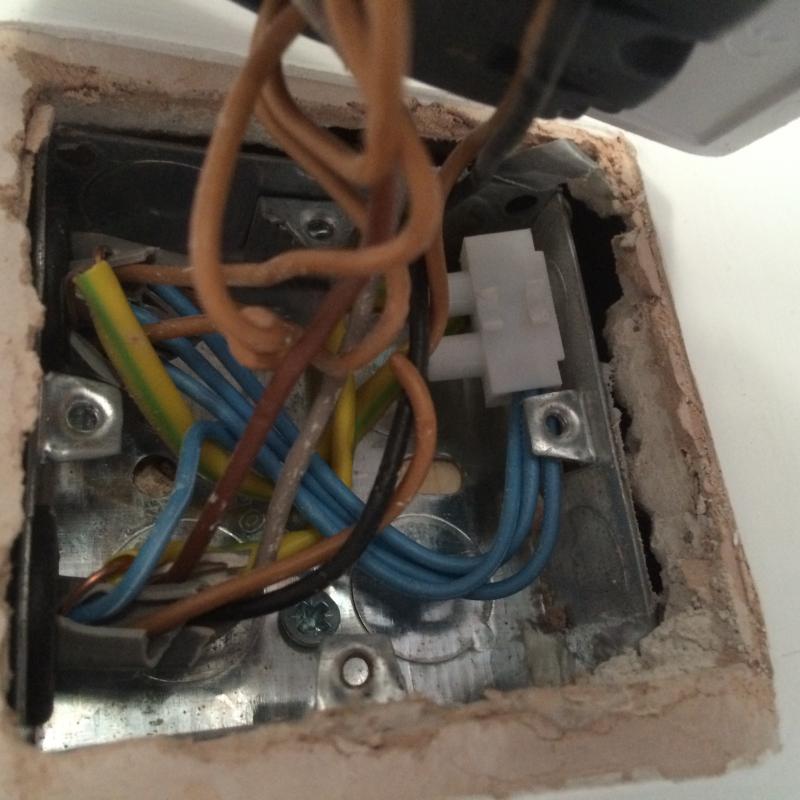

John I'm not at home at the min, but where would I connect the earth in the backbox?
Cheers John D, I'm going to stick with switches.... if she wants ambient lighting I will put the torch on my Iphone on :D
John I'm not at home at the min, but where would I connect the earth in the backbox? ... Probably a really silly question
That back box is so crowded that it's quite difficult to see what's going on - but aren't those green/yellow-sleeved conductors connected to an earth terminal at the back of the box?
