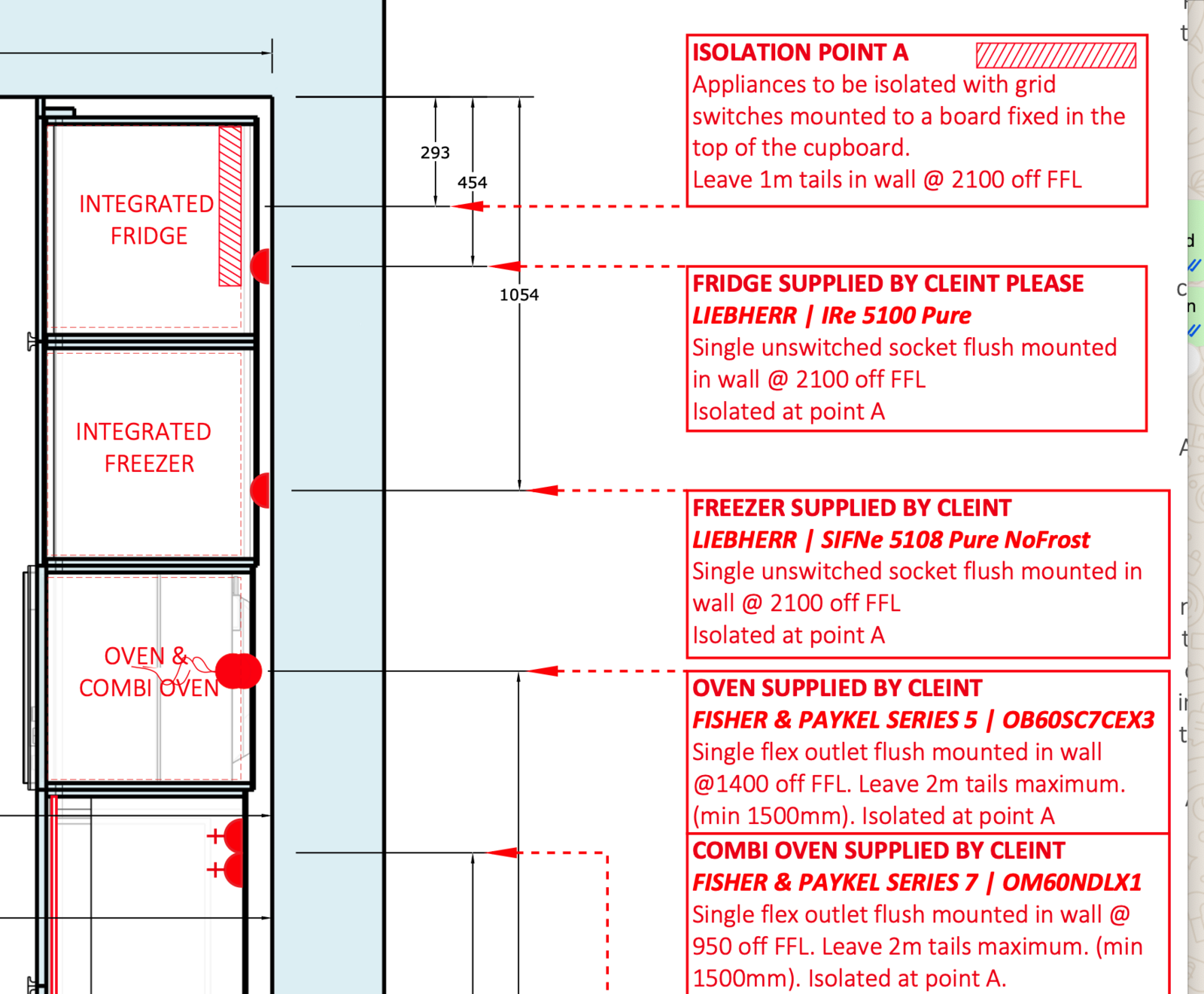

Hi all,
I'm refitting my kitchen at the moment and soon arriving at the point where I am installing our new hob/oven configuration. I am using the same dedicated 32amp circuit which supplied the old oven as previously recommended on here. This now will supply an induction hob on a kitchen island. I then have 4mm2 cable from this same circuit going under the floorboards and up into a temporary junction box on the wall where the ovens are going (the box just as a temp measure to keep the connections all out of the way/safe).
This is one conventional oven and one microwave oven. Separate units.
The kitchen company I'm using have handily supplied a guide as to what I should be using. With the one 4mm2 cable I have, is anyone able to advise how I configure this and what flex outlets/grid switches they'd recommend using? I clearly need to split supply of the one cable but not sure what the best way of doing this is going to be....
I'm not really getting the grid switch recommendation to be honest. These look as though they are for something different? Basically I have an 18mm ply board at the top of the freezer cabinet to install some isolator switches.

I've already had advice around the diversity and what circuit to keep it all on. It was more for the actual hardware I need in terms of fused connection units etc. Each oven is rated at 3kW. Hob is 7.5kW
Duel outlet plate? Two ovens in one side hob in the other
Thanks pete01. That potentially looks ideal, and the solution I was struggling to find....
So something like this?
https://www.tlc-direct.co.uk/Products/AA45DCOP.html
Then the two flex outlets at the bottom would feed each appliance (oven and microwave oven), presumably via a FCU so I can isolate them? I should add that the hob is wired separately as this is positioned in my kitchen island, with these two ovens then in a separate wall cabinet run.

Ok thanks both. I think in fairness I am probably overcomplicating this. The other factor I need to consider is that I only have 30mm clearance behind the actual cabinets so I'm struggling to surface mount anything. Thus looking at the duel outlet plate it only seems to come with the option of a 35mm surface mounted back box.
I basically need to be able to isolate the two ovens separately as you say opps...so can I just split this cable using wagos in a junction box, to feed two fused connection units that I mount in a convenient position.

Oven / cooker outlets should be flush mounted. If surface, then you are unlikely to have enough space to fit the appliance in front of it. They all need a 35mm or deeper box due to the size of wiring used with them.
Why?
They will be switched off only for cleaning or maintenance. Neither of which requires them to be separately controlled.
Grid switches are inappropriate for use with high loads in a kitchen. They are the favourites of kitchen designers who for reasons known only to them believe they are the solution for everything.
If isolators really must be shoved in a high level cupboard above a fridge where no one can reach them then it's this: https://www.toolstation.com/click-mode-45a-dp-switch/p10475 for the ovens/hob
and possibly this https://www.toolstation.com/click-mode-20a-dp-switch/p17782 for the fridge or freezer sockets.
No, they fit on any type of back box.
Well - you don't need to isolate them separately - you can if you want.
You can split the cable at the outlet plate.
You don't want FCUs for an oven.

So I can get the dual outlet plate, mount that on a 35mm back box in wall? I then have my two cables for each oven. See where you are both coming from (and agree) with the point around when am I going to need to isolate them separately. What should I then be using in between my outlet plate and the two ovens?
Strictly speaking - heat resistant flexible cable.
2.5mm² will suffice - or 4mm² if you prefer.
Thanks @EFLImpudence sorry I meant what switch rather than cabling. Presumably I need some form of isolator?
That is what I wasn't quite following with the advice around not needing to isolate separately- which completely makes sense but then I thought I'd have to do this anyway as they need to be wired separately. If I split the wiring to feed each oven with the dual outlet plate, I need to install some form of switch.
I would just have the normal cooker switch which would isolate all three appliances from the supply.
I like one switch to cover all the cooking appliances but people's opinions vary.
That makes no difference with regard to switches.
No.
Right I think I follow now- I was thinking about it the wrong way around and dual outlet plate first. What I should do is have one cooker switch, and then my cable from this cooker switch goes to the dual outlet plate to wire both ovens?
