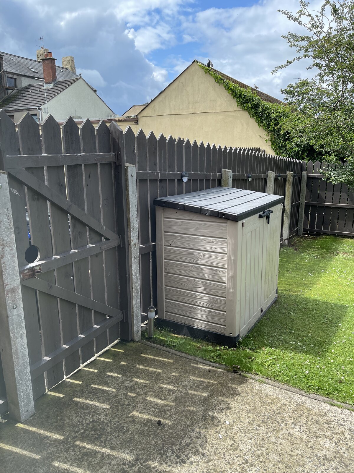

Hi guys,
I want to double-slot this fence for privacy.
Is there something used to keep the gaps between the slots consistent and what length of nails would I need?
Thanks.
Just use a spacer of the desired width. I would consider using screws rather than banging away at it with a hammer.
whilst spacers are a brilliant idea i fully agree with-------- the fact the timber vary in size between batches and moisture content it will be needing constant checking and adjustment about every third one to check over and under measurements
