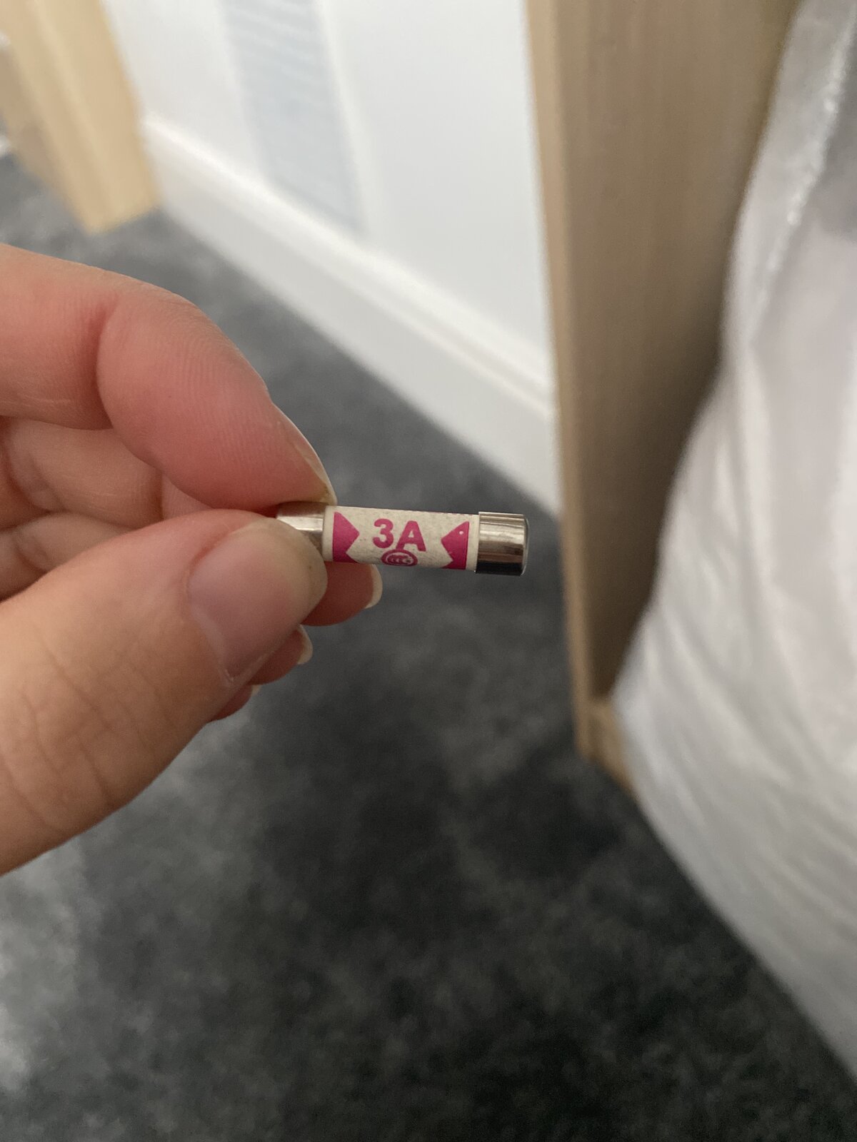

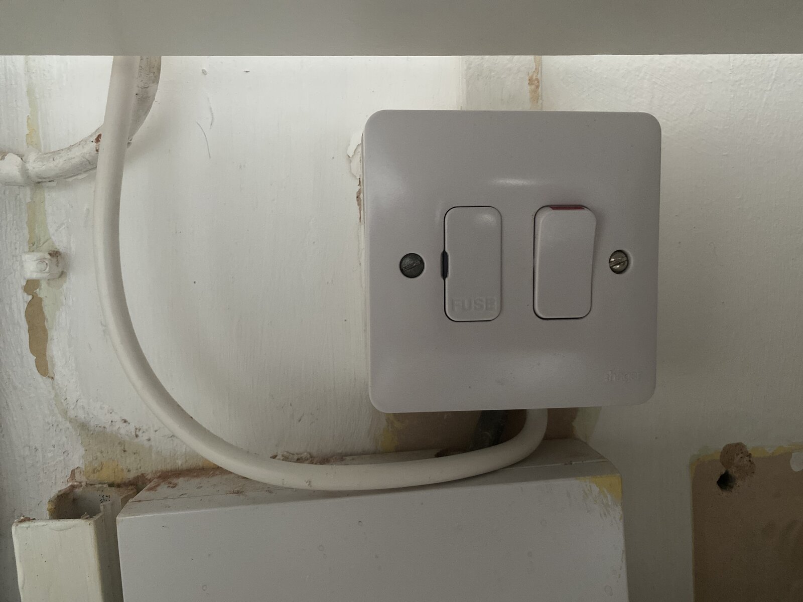

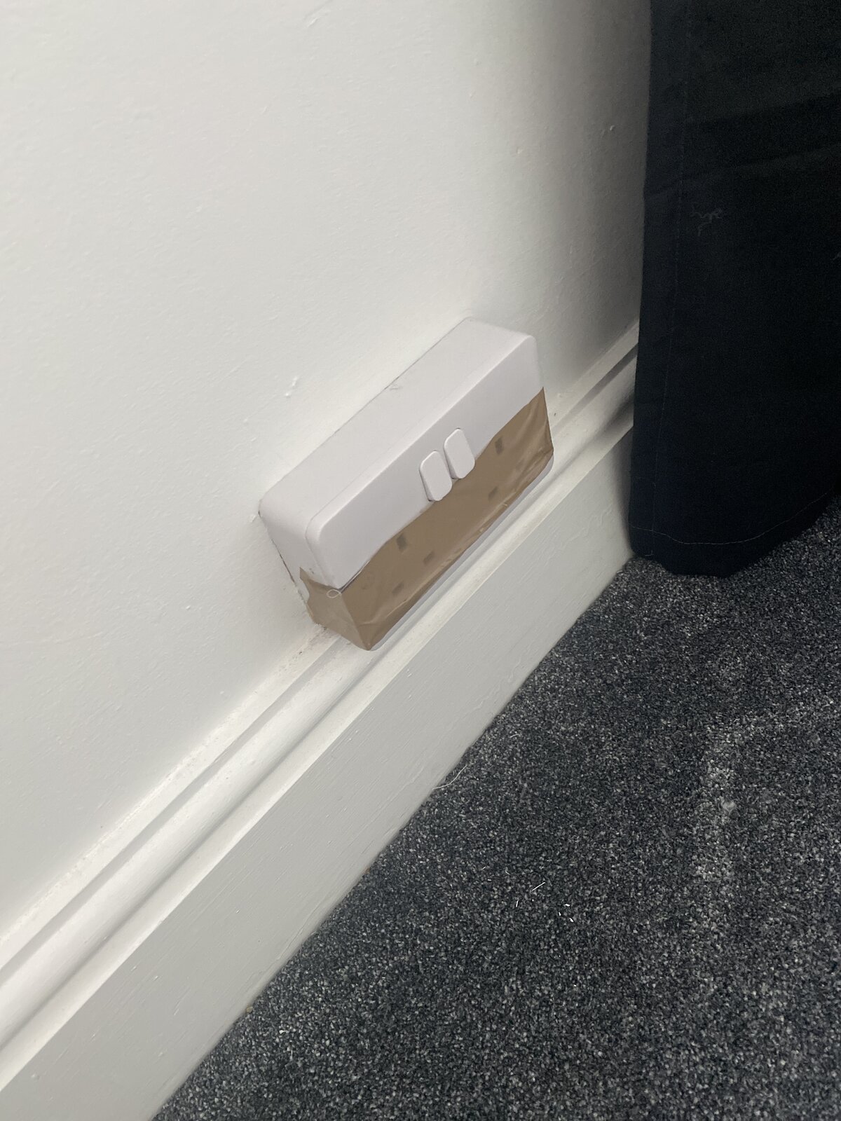

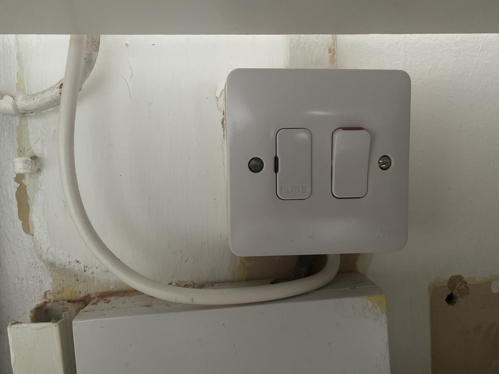

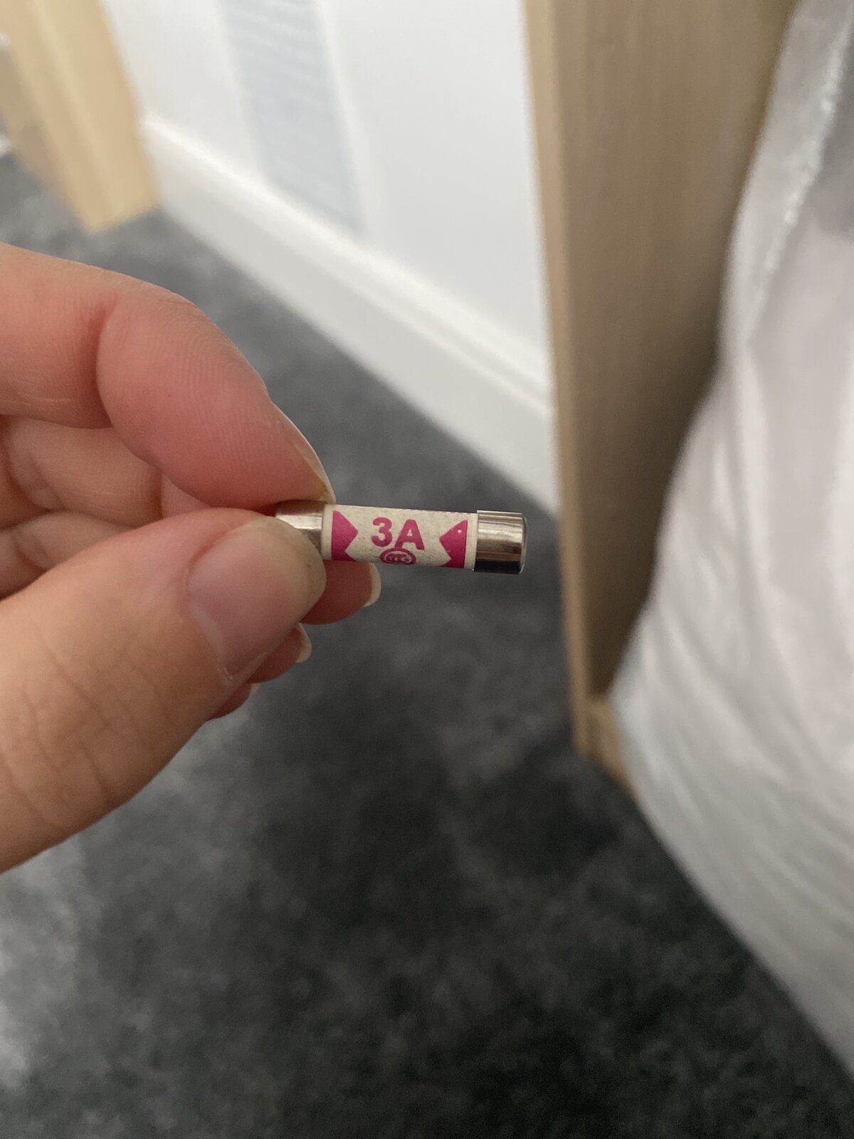

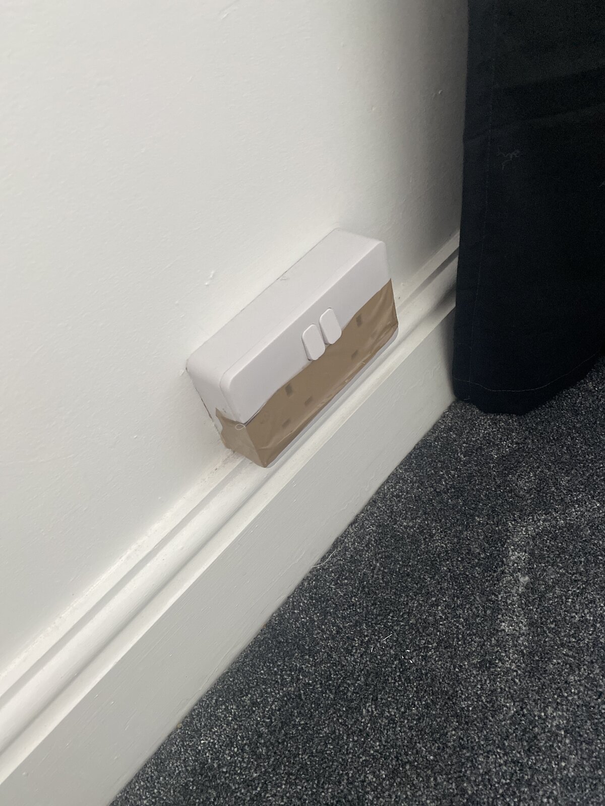

Apologies - I have put some photos of the fuse in question.

That isolating switch is feeding the boiler and the socket, but it has a 3A fuse in it, so anything over 3A you use on the socket blows the fuse.
I wouldn't do it.
Just use the socket for charging your phone or anything low rated, under 3A.
Would upping the fuse to 5/7/10 cause a risk to the boiler?
In theroy no, the boiler should have internal fuses to protect it, but in practice we have no idea if it has, if the boiler plugs in, and there is a 3 amp fuse in the plug, then the FCU can have a larger fuse in it, but it seems from pictures some one has taken a supply from what should have been a dedicated boiler supply.
Since all is surface mounted it would not be a big job to change it, if the supply is RCD protected, the problem today is new sockets need RCD protecting, so to change from a single FCU to a grid switch with multi-fuses would mean the new items will need RCD protection, so technically may not be permitted, it would not stop me in my own house, but an electrician may refuse to alter.
The load side had been used to feed the switched spur.
If the spur was taken from the ring side the switch was work as normal as would the spur.
