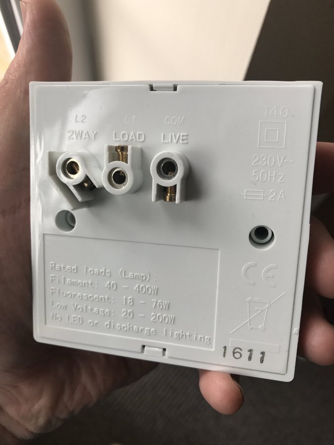

Hi, I've been having a browse but struggling to find help on here to match my situation.
I should say up front that for some reason in my area there doesn't seem to be any sparks that just want to change a switch...well not at least in the next 4-6 weeks!

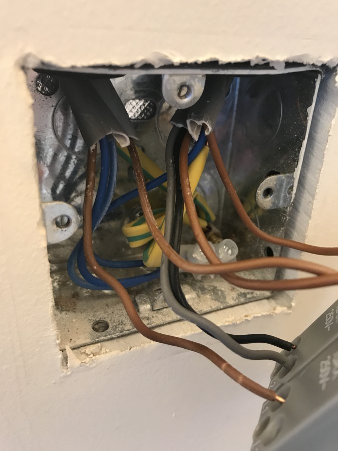

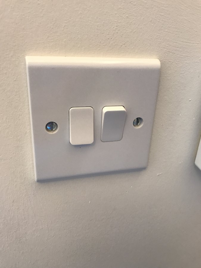

Anyway, to explain, I have a two gang switch in my vestibule. One controls the outside light and the other the vestibule light. There is another switch for the vestibule light in the hall so my thinking is to decommission the switch for the vestibule in the vestibule and just use wiring for outside light for the timer. Problem is when I look at the back I am not sure if I can just terminate the wires for the indoor light with a insulation block and connect up the timer? Is it more complicated than that and I'd need a spark?
I've attached pictures but any help and advise would be appreciated.
I should say though that the switch for the outside light is the left switch or the one that is off in the picture. :)
Thanks for any help.
Chris

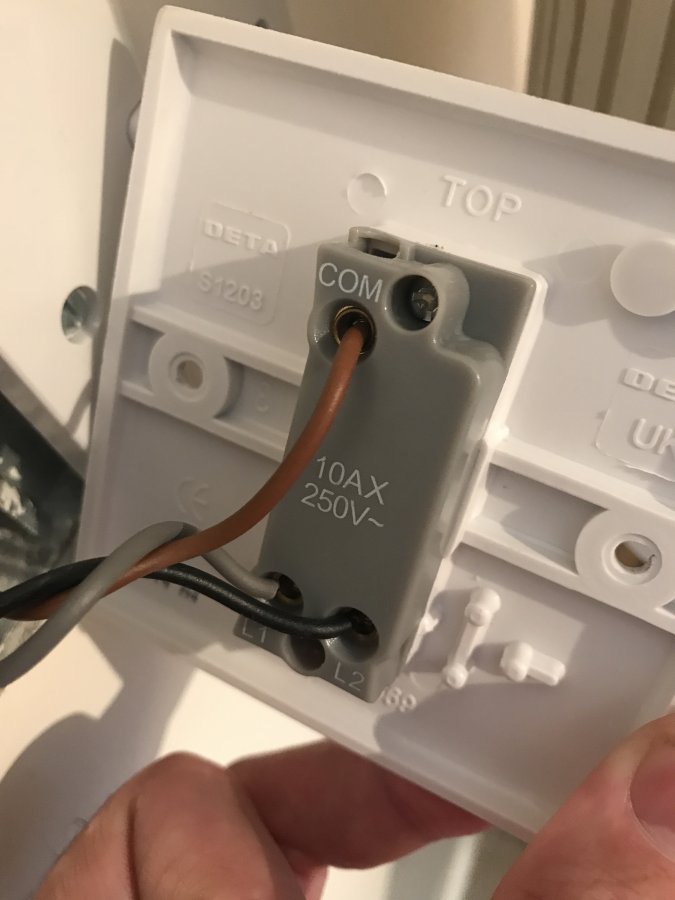

Here's the other switch for the indoor light.
Normally it would just be transfer Com & L1 to Live & Load respectively - but
I can't tell what the extra brown is for.
Are there any more wires in the "other" back box?
This looks like a bodge carried out by someone with very little electrical knowledge. Somewhere else there other electrical terminations that make this work, possibly in the back of the lights or a junction box.

The only other wires in the back of either of the boxes are Blue Neutrals which are connected together in a single insulator block in the two gang switch.

Assuming there are no other wires hidden in the hall switch, as I see it, this is quite straight forward.
The two brown wires in com of outside switch go to live of the timer.
The single brown of outzide switch go to load of timer.
Brown and grey of vestibule switch connected together in choc bloc.
Black becomes redundant and to be protected in a choc bloc, ideally at both ends.
I dont see any problems or botches in this set-up, in fact by many of todays installs this is quite good.

Somewhere there is some more wiring that we've not seen yet - but IF the current configuration works correctly and is safe (IF!) then Sunray's instructions will work, irrespective of where that wiring is or how it's connected.
Edit - wrong, no extra wiring.
The brown from the strapper cable (brown,black,grey) is connected to the outside light switch. Presumably line.
This goes to Com at the far switch, making it actually a two strapper system.
Another twin & earth cable goes to the light from Com at this switch and neutral.
