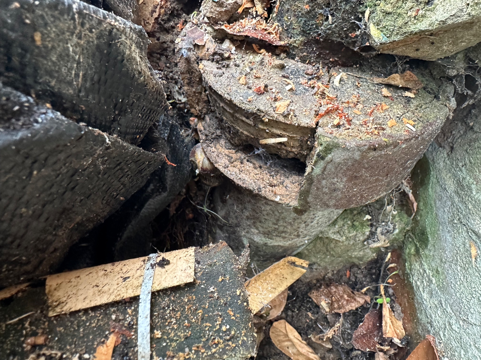

Good afternoon, I have some cast iron downpipe thats leaking, I’m having it replaced but it goes into what looks like cement pipe what’s cracked and breaking away. Has anyone come across this pipe being asbestos before please?

Thanks for replying, this was under some slabs with a bush next to it, I think the roots from the bush grew and cracked the slabs and cement so I’ve removed them (and the bush!) but was worried the pipe/bend the downpipe is cemented into could be asbestos which fell away while I was tidying up
That looks like it could be salt glazed clay with a cement filler around the cast. Water's got in, frozen and split the clay away from the cement

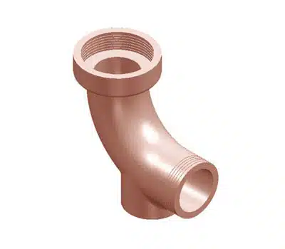

Could be something like this - a rest/socket bend
Need to dig down a bit to see what's below it.

Certainly get a plumber, experienced in soil stack work, in first. They should be able to assess what all may be needed and suggest if other resources may also be needed to do any groundworks etc
OP,
You appear to have a Salt Glazed socket'ed pipe.
There are indications that leaks or spill from the downpipe or the salt glaze is leaking or splashing on the wall, & maybe soaking the ground. Repairs are needed. Any signs of internal water stains?
Why not remove the rockery & debris around the socket, and dig down a little to look for a possible bend then show a pic at cleared up ground level - a pic showing the CI downpipe would also help.

Decent Plumber or Builder could probably repair it, although until you expose a bit more, it's impossible to say what work is involved. Common problem with older properties, you've a cast iron pipe going into a Clayware drain, any slight ground movement and there's no give in the joint so it just cracks.
Would need to dig back a bit, expose the underground bend and see what condition that's in, may need the clay bend replacing if its beyond repair, but that would give the advantage of allowing the new joint to be flexible to prevent a reoccurrence.
As Madrab says, don't worry unduly in the short term, there may be a slight leakage when the WC is flushed, but that shouldn't cause major issues, joint looks intact enough, along with gravity to allow the majority of flow to go in the right direction, until you have more time to deal with it.
