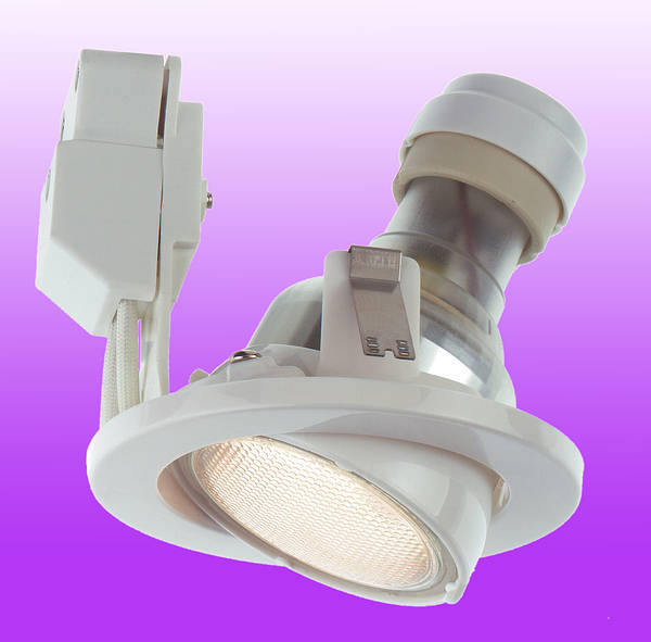

I dont think so, BUT there are CFL fittings where they are keyed - GU10 GFLs have notches in them so that the plastic fittings designed for them can only accept them.
You can just see the notches here. These are the best of both worlds - they have a wide beam, have better light then halogen, and run at about 50 degrees, about 200 less than halogen. You can touch them during use, they wont burn joists. The only downsides are they some people dont like the light they give (its sort of unnatural, but you can get different colour temperatures of white), and they take about 2 minutes to reach full brightness.

Are the regulations but note "Unless otherwise recommended by the manufacturer" and you will find some which can be mounted closer. You need to read manufacturers recommendations.
The CFL GU10 fitting I linked to above is a shade over £10. Your fittings will be £100+ each ban. :rolleyes:
Another option is PL downlights, which start at 80% brightness immediately, and get to 100% quickly, but use slightly bigger luminaires (fittings) to do it.
