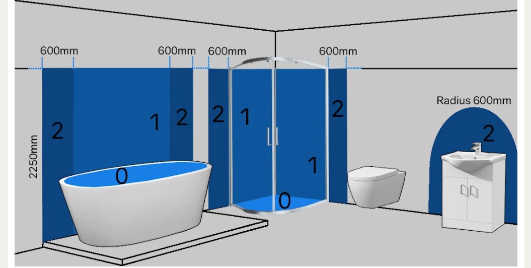

I have just seen IP65 is for Zone 1 and 2 which means is OK for what am doing, see below pic
Just for accuracy:
Luminaires (lights) in zones 1 and 2 must be at least IPX4 and stated suitable by the manufacturer.
Outside the zones (as in the OP) there is no restriction.
In England, work in bathrooms and the like, outside of the zones does not require "notification" to the Local Authority.
If it did, that would be the case whoever does the work.
Being a "registered" electrician - or not - has nothing to do with the ownership of the property.
The diagram shown is not quite correct around the shower cubicle and there are no zones around a basin.
There are very few correct diagrams on the internet regarding the zones.
This is correct:
