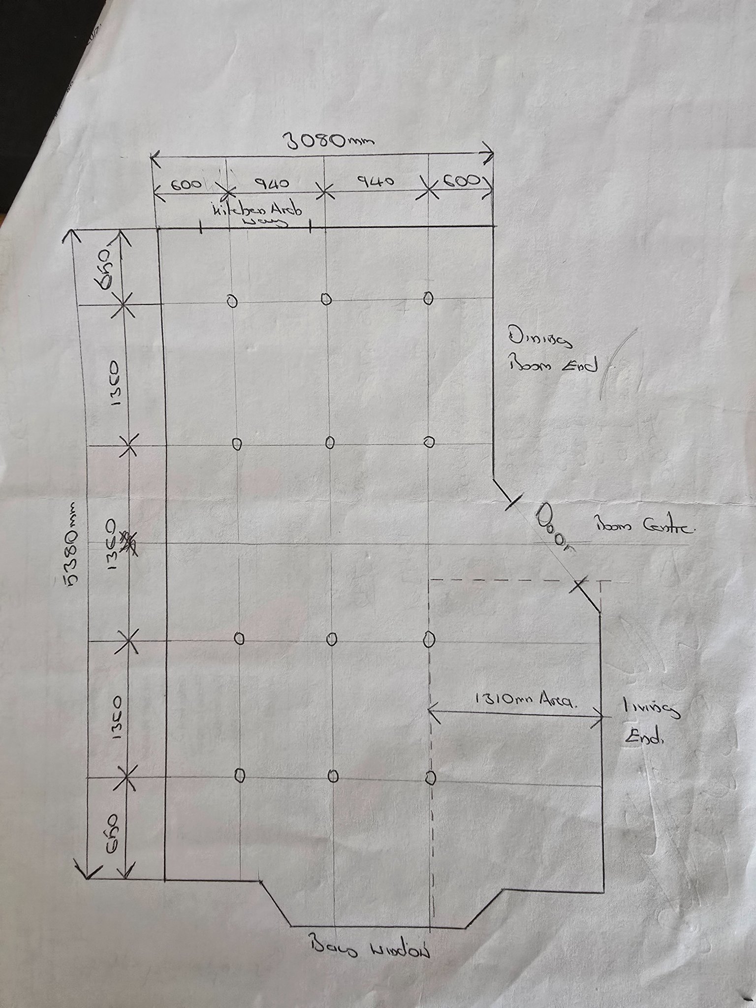

Hi
I am after a little advice on down light layout of this room to see if anyone has any better ideas, the current layout i have drawn gives 6 lights on each side of the centre line of the room when you walk in the door which are operated of separate switches and keeps the lights in a line down the room. They are currently positioned away from any gypframe in the roof and do have the ability to move a bit.

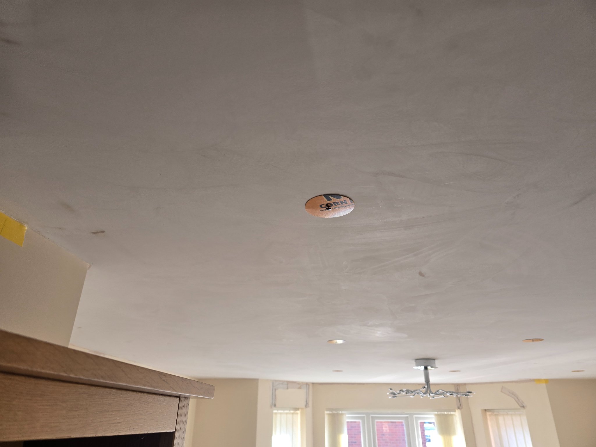

My OCD is having my life as to the position of the lights down the odd shaped end of the room, i would have liked them aligned with the window centre running back but that wouldn't work and there just seems a big roof space with nothing on it ( the red area ). I have put some disc to the roof where the lights would sit and that area just looks odd, this is the area the tv sits, i was going to have the lights down that end at different spaces but they would not be inline the rest of them
Any ideas welcome before i build a small media wall to reduce the gap :ROFLMAO:
On first glance there's too many lights?
And that layout tends to look bunched when they are not spread out more towards the walls
Yes, maybe lose the middle row move the outside rows in a bit and put 2 inline where the wall goes out.

Yeah i did think about removing the centre row and only having 4 in each section but would have to move them a bit closer together.

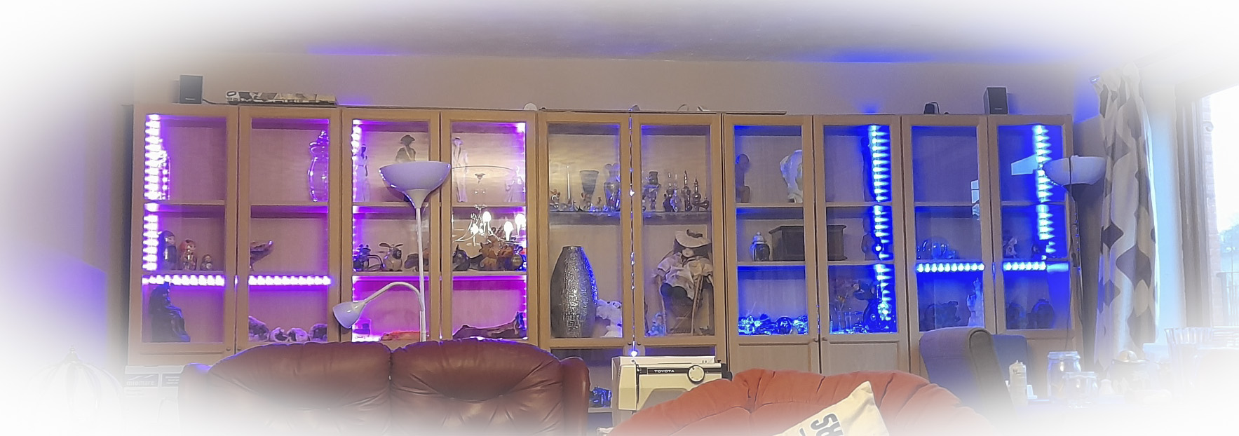

Why down lights? My room also an odd shape, and the ceiling lamp is to one side, so I use cabinet display lights, and up-lights, and spotlights to add to the basic light.
The main thing with a large room, is often you don't need whole room bathed in light, my billy bookcase display lights when set dim just light up the display 20230227_170703_1.jpgbut turn the up and to white, and it can light the room. So you want control so you can select what you want when you want it.

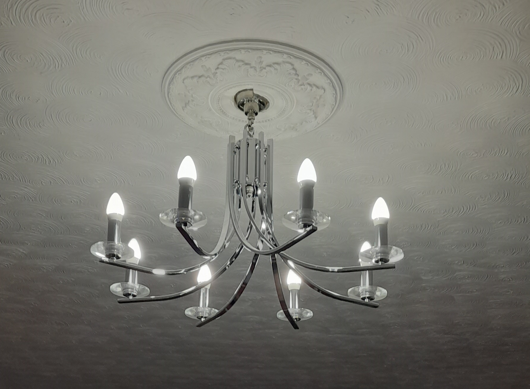

12 x £5 for all smart bulbs, is £60, but my chandelier Ceiling light.jpg was not cheap either, not smart bulbs, but it is controlled by a smart switch.

Three thoughts
1. Have 2 x 6 on separate switches
2. The ones near the bay window need to be closer to the window and the 2 in the middle of that 6 need to be in the centre of the outer 4 ( hope that makes sense)
3. The two banks of 6 need to be closer together or you’ll get odd light distribution between them
And where are the joists?

2x6 on separate switches was the plan as the current lights are like that anyway seperated, yeah i get the jist of what you mean

I would space the lower six evenly across and then only use four in the upper part of the diagram which can be inline with four of the six.
