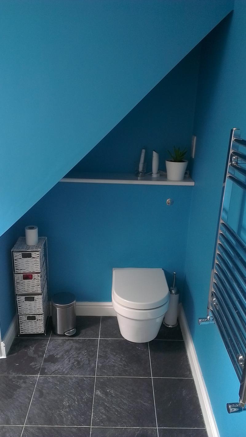

I have ripped the sink out put isolation valves on cold and hot pipe. Basically I'm ready to tile. I have an idea what I would like so I have a photo here I found online pretty much what I would want. Maybe a different shade for floor tiles. Halfway with the tiling is also what I want :)
I would say I am still in two minds what to do with the top where I am fitting flush plate. Like in this photo it is sealed with tiling. Or do I fit a lid laminated mdf in case I need access? Surely if the plumbing is all fitted correctly I won't need access?
I am fitting a lid. A couple of days ago a plumber said to me that he is often having to rip tiles off to repair and replace concealed cisterns.
Regarding that photo, I would have floor tiles the same colour as the lower wall tiles. I would also change the upper level of tiles to be the same colour as the lower tiles. That would make the room look bigger.
NEVER block access to your cistern and isolation valves.
It will come back to haunt you.
Ok advice taken on board :)
Can anybody point me in right direction with images/photos of like the one I posted to give me ideas? Preferably with a laminated mdf top that lifts off. I think I will go for a glossy one maybe a beige/chocolate surface.
