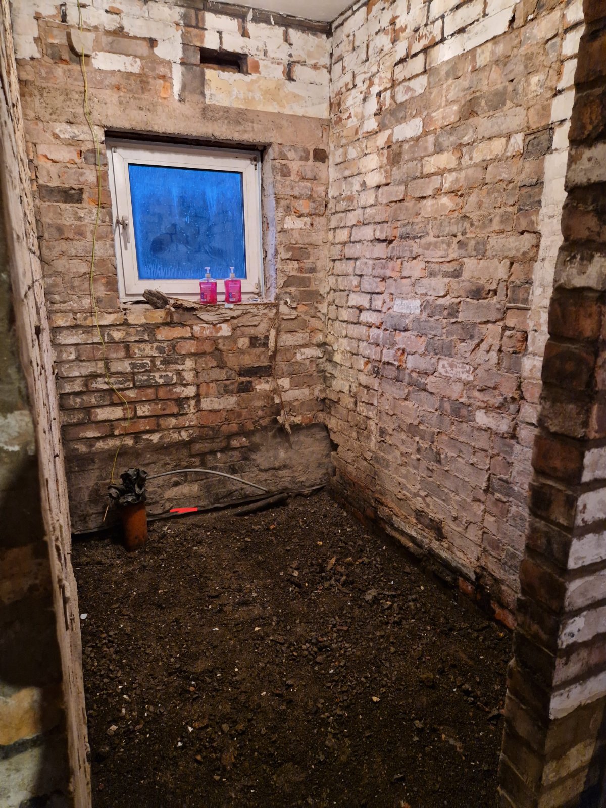

Hi guys so i have a question to ask i am doing a refurb of this old house im been fitting a dpc on the inner skin 1 brick up from the floor level im looking to tape dpm to the bit of dpc that sticks out the wall would this make a decent job or not ?

A pic of what im doing dpc 1 brick up looking to seal dpm to the bit of dpc sticking out

Thanks for the pics but they are difficult to understand with the dark shadows & the tilted pics - perhaps you can correct the pics & bring some light in?

Short answer, yes.
You could also cut a wide strip of dpm and Leave it hanging out, until such time you put the main dpm in and tape them together.
Other option is to black jack the wall just below the dpc and stick the dpm against it.

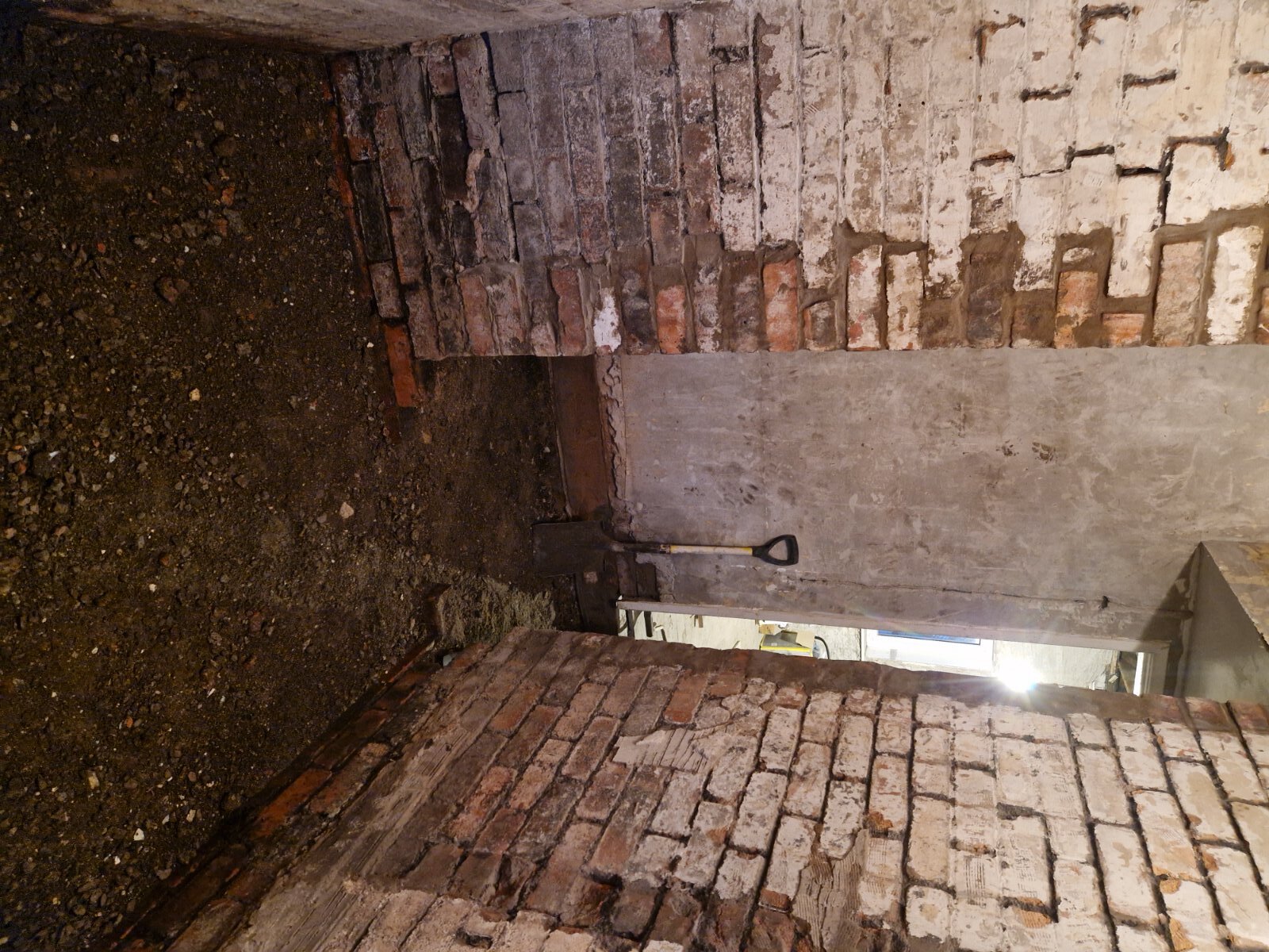

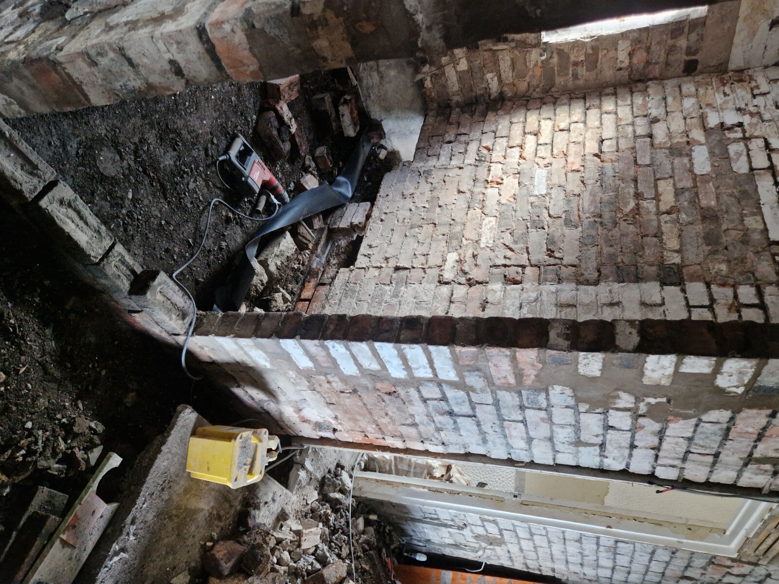

You can see on the this image i have fitted the DPC 1 brick up from ground level i plan to install dpm sheet taped to the little bit that sticks out from the wall then blind it with sand then finish floor level will be 2 bricks above the dpm
I only have about 1 inch to tape to if i had time again i should of fitted a wider dpc maybe 18inch and then i would of had a good bit to tape to
Just bought some visqueen zedex mastic looking to use this to make a seal aswell

Your chosen mastic will work ok, What's going over the sand?
Bring the membrane up the wall to meet the FFL, preferably slightly above it.
Plaster/plasterboard/skirting will hide it anyway.
Your DPC should go at FFL not one brick above. It leaves one brick course vulnerable to damp. Polythene lapped onto it will be damaged by skirting etc.
DPC can be below FFL but not above.

The damp proof course is not at final floor level its one brick above the sub base level but the final floor level once the sand has been put in and damp proof membrane laid and infilled it will be 3 bricks above the damp proof course
So the plan is get the sub layer to a rough level blind it out with sand
Lay a sheet of dpm over the sand to meet the parts of the wall where the dpc stick out tape and mastic along the edges
then as a double up lay another full sheet of dpm and this time instead of it been cut as a square sheet and taped at the ends to the dpc the ends will be folded up the wall up the 3 courses to the final floor level more sand will then be laided onto to prevent any damage from the infill
Then concrete will be laid ontop of the infill to the final floor level which is 3 bricks above the dpc level then any excess dpm going up the wall be trimmed off at final floor level
