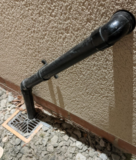

Separately there was some new drainage put in down the side of the house to take the waste water from the kitchen and utility room (the blue line on the diagram). The waste from those rooms goes out through a black pipe into a drain like the picture below. This joins the main foul drain under the driveway.
There are two of these- one for the kitchen, another for the utility room sink.

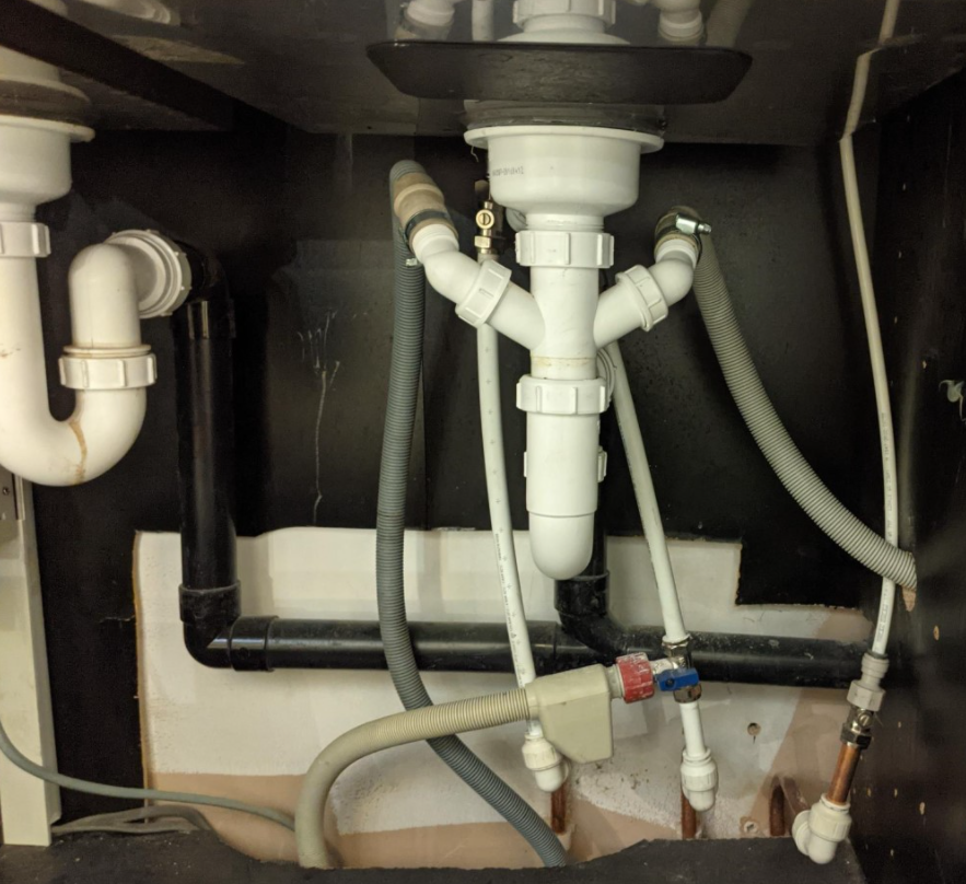

The WM is where we generally get the smell, although we do get it in one of the upstairs bathrooms too. The WM waste is actually connected to the kitchen sink waste - I wish it wasn't, it's quite noisy. The WM waste is the flexible grey tube on the right:

I have to wonder if the smell around the Washing Machine is actually due to a build up of crud inside the machine. These modern low temperature detergents are all well and good, but the machine may never get hot enough to keep the filth inside at bay. I would also lift the drain hoses up slightly, so they rise up to almost touch the underside of the sink before dropping to join the trap.
As an aside, I would keep an eye on the water connection to the plastic pipework, appliances shut the water supply off almost instantly after filling, if it is constantly jerking the Tee every time it cuts off, you may run the risk of something failing at some point in the future. If it's not found quickly, there will be some water spilled....

Hi, Had a smelly washing machine at work, when the sink was being emptied, waste water was being back siphoned into the WM. Also saw the tub filling with 'water' when not in use. Just a thought.
