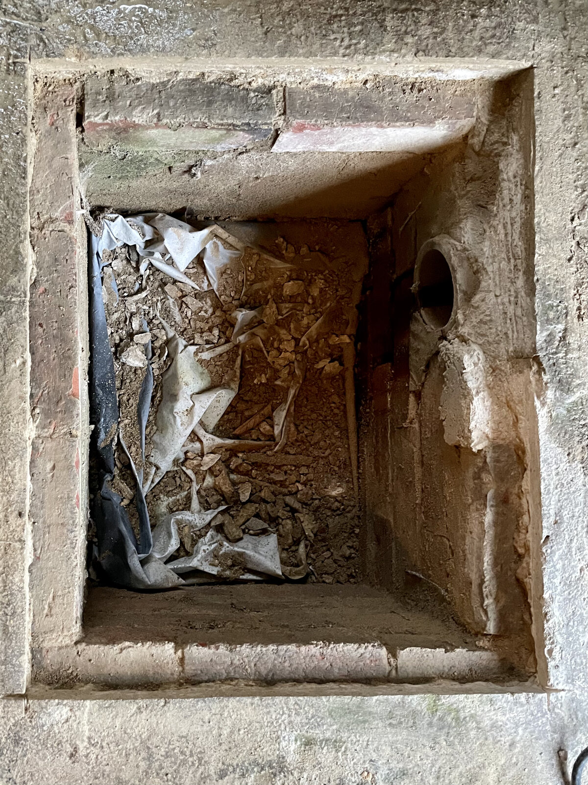

Hi.
I've got an old drain hatch that I'm replacing as it was completely corroded. Unfortunately the original one was seemingly a non-standard size and I've not been able to identify an exact replacement. It's not far off the standard 60x45cm size and I wanted to get some opinions on whether putting one of that size in is a good idea or not.
The photo shows the size of the hole and the brick chamber underneath. On the right you can see where the bricks have been all smashed up adding in the entry for a drainpipe at some point, I'm assuming I can build that back up with a thicker layer of mortar when I put the frame in.
The interior size of the brick chamber is 47x61cm, largest possible size with the current opening I've cut out is 55x68cm, and the cut out is about 4cm deep.
Would a 60x45 interior opening hatch have a frame that is wide and stiff enough to work on this opening, and if not can anyone suggest what I need to do, please?
This is in an outbuilding and will get occasional foot traffic only.
