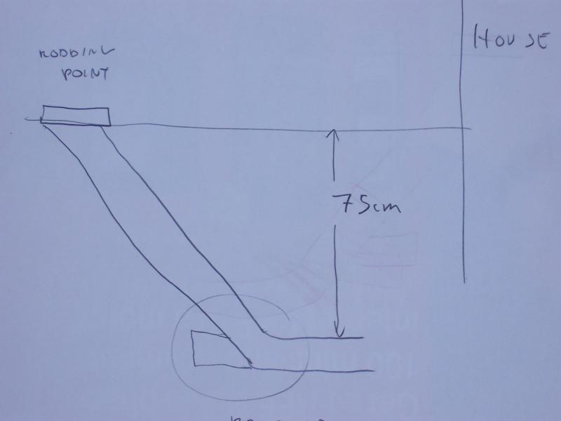

Thanks r896neo, he is going to Y connect into the rain downpipe at the U bend (between rodding point and vertical downpipe) which is 75cm below ground level (he evacuated yesterday).
My concern is that if the gradient is too steep the water will not have enough 'time' to get into the french drain. So am worried that this water that doesn't manage to get into the pipe will simply flow down the trench, NOT get into y connector/rain downpipe and create a build up of water next to my house.

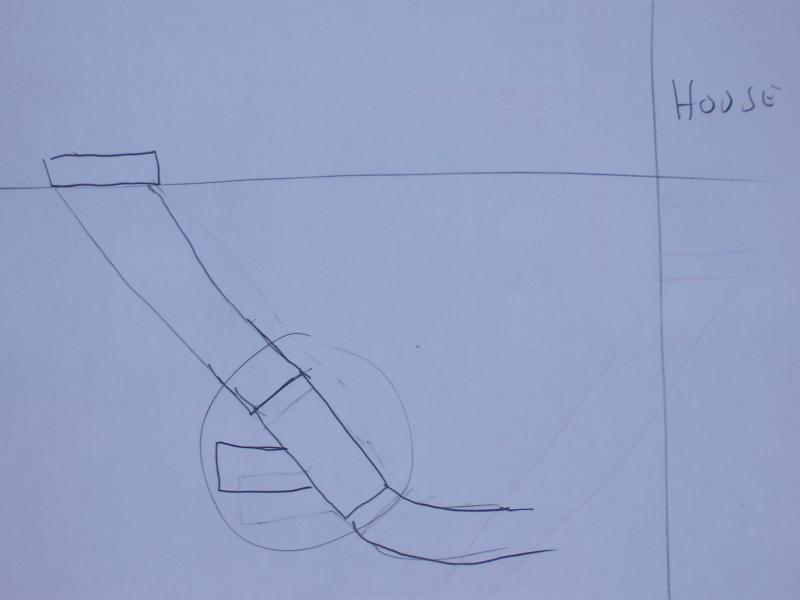

I am wanting to suggest to him to break into downpipe say at 45cm below ground level, as the maximum run of french drains I will have is 17m. This will allow for a shallower gradient for the entire run, thus increasing water collected into drain??? My two ideas for doing this are:
Sawing pipe and inserting y connector a bit further up.
OR
Using two 87.5 degree bends, this has the advantage in that these two pipes can be rotated from the y-connector joint to get the desired depth of discharge for end of french drain.
It just seems a bit extreme to be 75cm below ground for a small garden.
Water will always find its own level, and take the path of least resistance. It wont build up if there's an easier route to take, i.e. into the drain.
I'm not sure i understand. The gradient has absolutely no bearing on how effective the land drain is at collecting water??
As for your concern about water gushing down a steep slope and missing the y into the drainage system, whilst i understand your thinking and agree that it's a valid point the rate and volume of water coming through the pipe is not really flowing. water enters a land drain almost like uncovering a spring, it sort of floods up into it until it has enough volume to start running away. At no point is the pipe ever flowing like a conventional drainage system and as a result where it joins the y connector the same thing happens, any water that doesn't run straight in simply rises into the space rather than trying to push its way on down through the ground.
Of course you need to make a definate end to the channel as it connects into the y and this can sometimes simply be done with lumps of clay moulded and beaten in around the y or if the soil is not up to that a small plug of concrete.
It sounds like your landscaper knows what he is doing so i would be happy to trust his judgement cause he is there in the trench rather than me or someone else on the forum.
water enters a land drain almost like uncovering a spring, it sort of floods up into it until it has enough volume to start running away....as a result where it joins the y connector the same thing happens, any water that doesn't run straight in simply rises into the space rather than trying to push its way on down through the ground.
