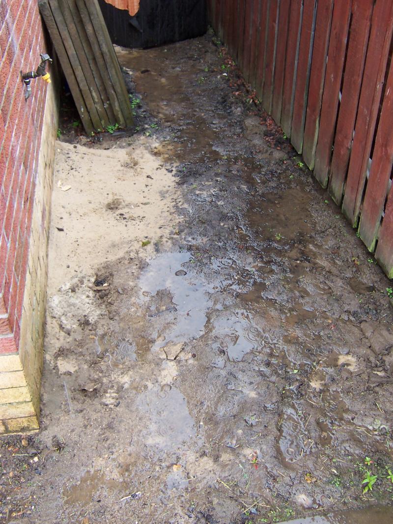

Finally worked out how to upload photos, here are images of the side of house in question.
The 'sand hill' was constructed by myself to ensure water moves away from building.
and up closed to shed which will be getting destroyed by landscaper
Anymore comments on where drainage should go would still be welcome.[/img]
whilst your idea of the sand is noble it is worse than having nothing there as sand will hold water quite badly and therfore be holding it against the house, just remove it.
As for where to drain the trench or french drain to you will have to make that judgement yourself as we can't see the whole site or the lie of the land.
Bear in mind though that the volume of water will be relatively small and it will be quite clean too so running it onto a driveway would not be a problem.
The pictures of that area are pretty bad, have you dug down to see what is there? First start with removing the landscaping fabric and then dig a bit to make sure there is no concrete or anything under there.
