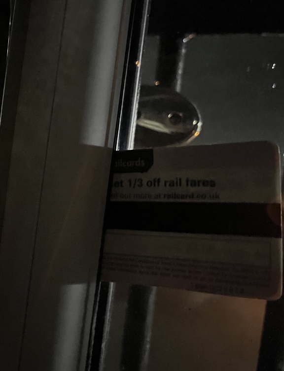

My question on here, regarding the draught from around the glazing panel and beading, was not actually asking how to resolve its, but was.. should this be happening at all or have I taped over some inherent feature which may have redirected air flow or something;

I totally agree that you should not have to be paying to fix this yourself. As goes the glazing, there should be no way for a draught to get round the glass. It's all fitted within the glazing aperture, usually the sealed unit is 8-10mm smaller than the width and height, with ' packers ' used in strategic locations to hold the unit it. For internally glazed frames, such as yours , It is pushed out to touch the rubber gasket on the external face and then the beads knocked into place with a rubber headed mallet to create a nice tight fit to the rubber gasket on the beading , there should be no gaps between the glass and rubber gasket to allow any form of draught

Well, the gazing panel of the French doors feels secure, with no movement when the panel is pushed, although I can slide a railway ticket in between the beading and glazing panel but I can’t do that on any of my other double glazed windows, although I’ve just discovered another issue in bedroom, which explains the draught in there, as there’s a gap all the way down the hinge side of the bedroom window.
Well you shouldn't be able to get anything between the glass and rubber gasket without applying some force, so a paper ticket shouldn't push through.

It’s a card ticket, slid between the glass panel and the beading, using very little force, although there’s some resistance but I can’t do it with glossy paper leaflet.
Can you post a picture of the railway ticket that you say you can slide between the glazing bead and the glazing panel (I assume you mean glass panel/glass unit), the glass unit should be clamped tightly between the inner rubber gasket on the bead and outer gasket, you should not be able to slide anything in, if you can then the glass unit is the wrong thickness
Rail ticket and yeah, I can slide it from the indoor side, in between the plastic beading and the glass panel, there’s a little bit of force but very little and when I try and do this on other double glazed windows, the card bends/folds instantly.
So, would the glass being the wrong thickness, allow a draught to occur around the beading?
