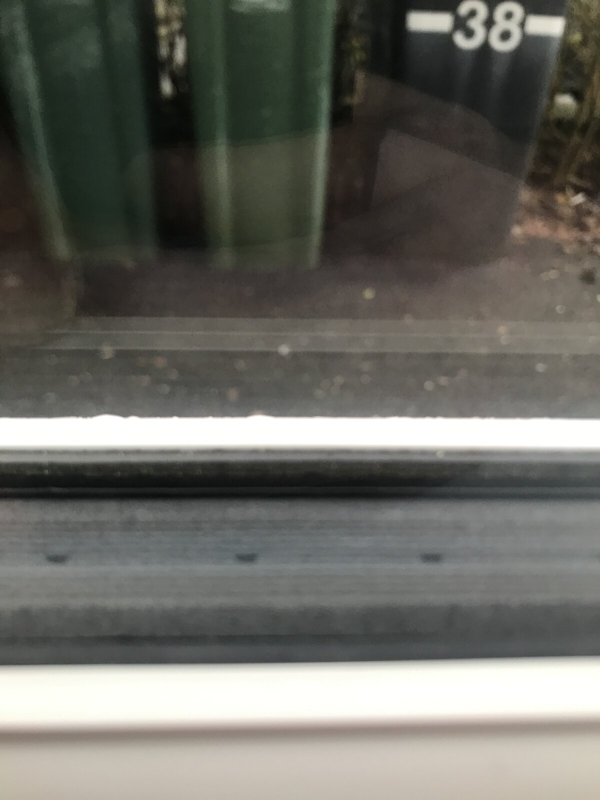

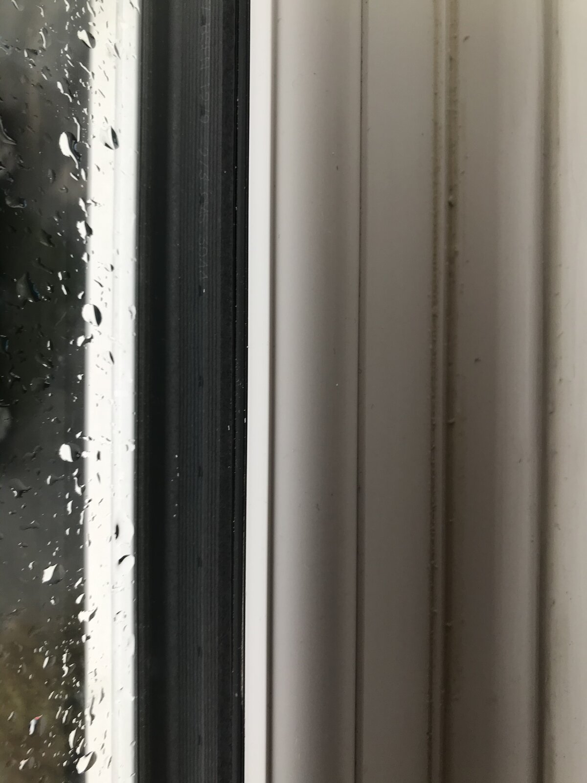

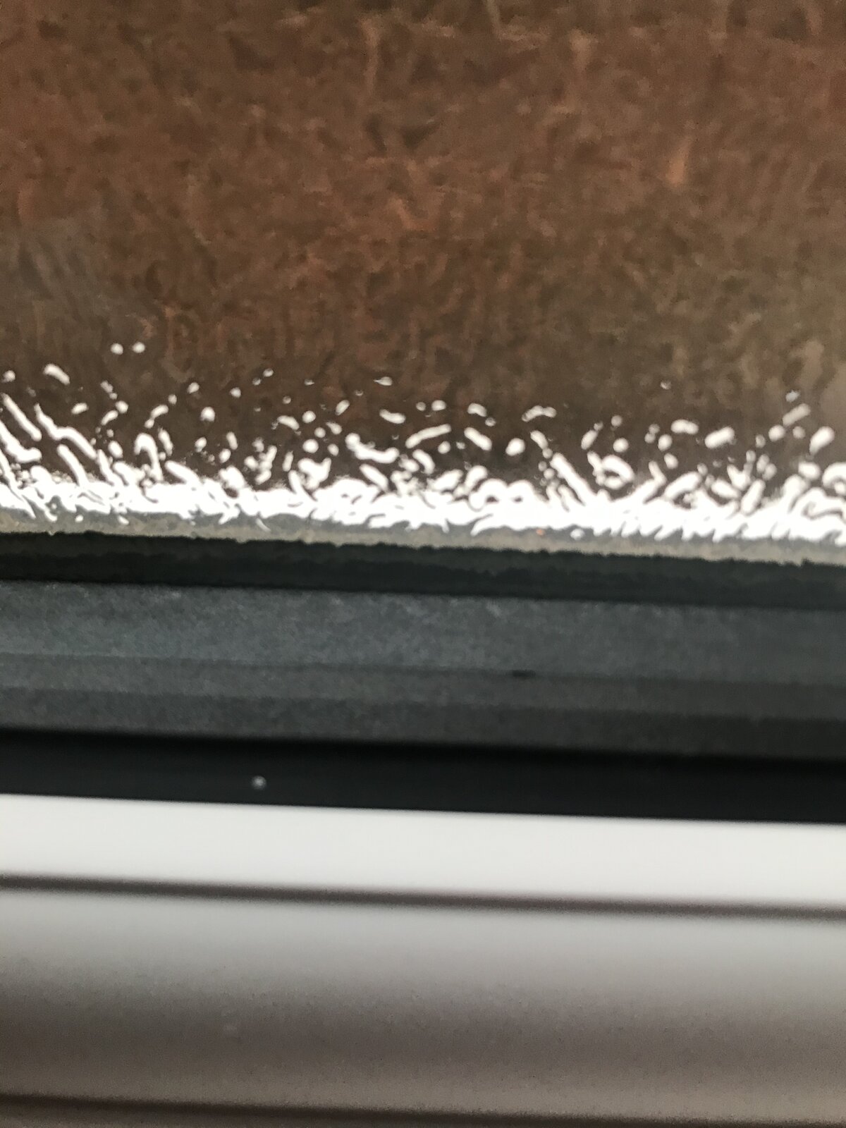

Keep getting draughts of cold air coming in from the gasket (I think this is what it’s called). It’s the rubber seal bit between the upvc frame and the glass.
any ideas how to stop it?
I’ve attached a pic but it’s not easy to
See - the pic is on its side as couldn’t rotate it!!!

Only way you'd get draught through the gasket is incorrect gasket or incorrect thickness of sealed unit, and thats an extruded gasket ( part of the bead ) by the looks of it...have you had the sealed unit changed recently?

the seals on the newer windows (fitted as part of extension) appear to have the seal flush against the window at an angle

Both pictures show gaskets in completely acceptable places. Picture 2 is a gasket that is an integral part of the bead and made as part of the ' extrusion '. Picture 1 its slightly harder to tell but could be a ' wedge ' gasket. I would say that picture 2 looks like the newer window due to the gasket, as a lot of manufacturers changed it so the gasket became ' sightline ' and were as invisible as possible. Neither window looks overly old either as both appear to have ' warm edge spacer bar ' ( albeit different makes).
As goes your draught... can you slide a piece of paper between the glass and the gasket , without to much force? If then yes something would appear to be wrong, if you can't then the ' draft ' can't be coming in from the gasket

Your pics aren't clear enough to tell if the seals are fitting correctly and all the way round. However you should be able to check this and any gaps should be visible or locatable by using the paper trick. Are the windows properly sealed outside with caulking/sealant i.e. where the frames meet the masonry/brickwork? Check that also to ensure no gaps.
