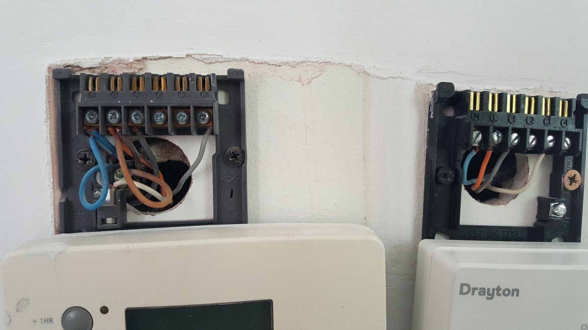

Hi, I hope that someone can help me with what should be a very simple question, but I'm very bad with plumbing.
I disconnected and reconnected the wall base of my Drayton digistat scr +rf but forgot to take a picture before that.
I just hope someone can confirm me that the connections are alright before I plug everything to the boiler!
Any help is much appreciated!
Thanks Alex

To do that, first we would need you to tell us what is connected to the other end of each wire.
Unfortunately, the choice of wire colours varies from installation to installation as they are chosen by the original installer.

Or is it enough mentioning that I did only touch the Drayton thermostat and not the programmer on its left (so the programmer wiring is right)
The Drayton SCR wiring is comprised of a switch (terminals 1 and 3) plus a Live (L) and Neutral (N) So you are using the correct terminals, but are the correct wires in them?
N = Neutral
L = Live
1 = Switching wire
3 = Switching wire
If you know for sure that the SCR blue wire is actually a Neutral and the Orange is the Live supply, then the remaining two wires (white & grey) will be the switch wires and will go to 1 and 3 as they are (it doesn't matter which way around the two switch wires go)
However, if you are in any doubt about the blue and orange, being the neutral and live, you will need to check them out.
