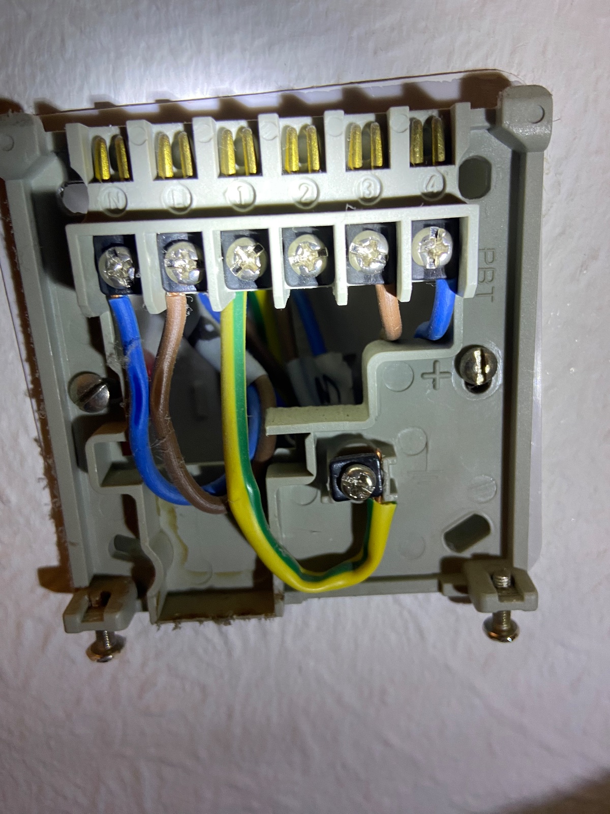

I have attached a pic of the old wiring backplate, and have sussed that the wiring terminals are as follows:
  • N – Neutral (blue wire present)
  • L – Permanent Live (brown wire present)
  • 1 – Hot Water OFF (not always used)
  • 2 – Hot Water ON
  • 3 – Central Heating OFF (not usually used)
  • 4 – Central Heating ON
  • Earth – Green/yellow (parked on earth terminal)
I haven't bought the new controller yet, but I was wondering if anyone can tell me if I can reuse the existing backplate and what rewiring I will need to do?

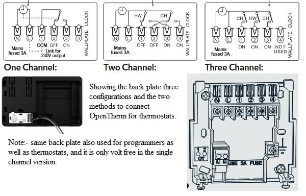

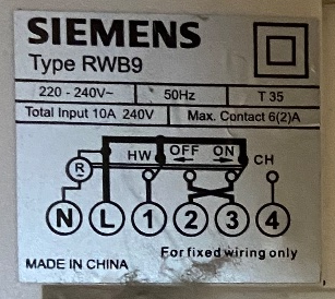

It seems there is a change, in the main terminals 1 and 2 are not used. This
however seems to show 1 and 2 is off the same as Wiser and Hive, so seems you have read the diagram wrong? And they are the same, it is the earth wire which seems wrong, can't work out why ever put there?
According to the installation instructions it should fit onto an industry standard wallplate, so should clip on. No wiring alterations necessary
Earth wire is correct in the earth parking terminal.
Earth wire is clearly terminated on the earth terminal screw.
Two channel wiser is HW ON = T3 as is the Siemens... and CH ON = T4 as the Siemens is.

Then look at the 3 Wiser wiring variations within the same backplate!!!
