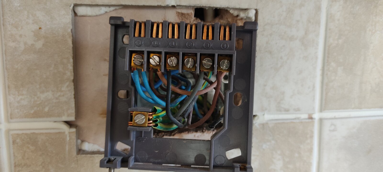

Drayton Wiser + Worcester Ri 24 issue with heating but i can get hot water on.
I think it could be your joining of the red and yellow wires from the old thermostat. Do you have a photo of how that thermostat was wired up?
yes i do have it.

It’s all mains switching, so should be 230/240 Vac. Looking back at your previous wiring, it does appear correct, so it’s either the Drayton or a dodgy connection/wire.
OK, i see the orange wire coming from the port valve. It is joined with a couple of brown wires and blu wire. Blue and orange go to pump and the last brown goes back to Drayton wiser box.
First of all completely forget the colours of the wires they mean nothing whatsoever, only the colours of the wires from the mid position valve (what you wrongly keep calling the port valve) Can be relied upon. The orange wire should only go to the boiler switched live and depending on the boiler also the pump , nothing else and should never connect to the wiser

Yes, this is the case, the mid position valve :) orange cable is connected to Demand input (LR)/ switched live cable.

At the Drayton side, the black wire (1 HW off) is connected to a grey wire that goes to mid position valve and thermostat black wire.
the Grey wire (3 CH on) is connected to the hot water tank thermostat brown wire.
Brown wire (4 on) is connected to mid position white wire.

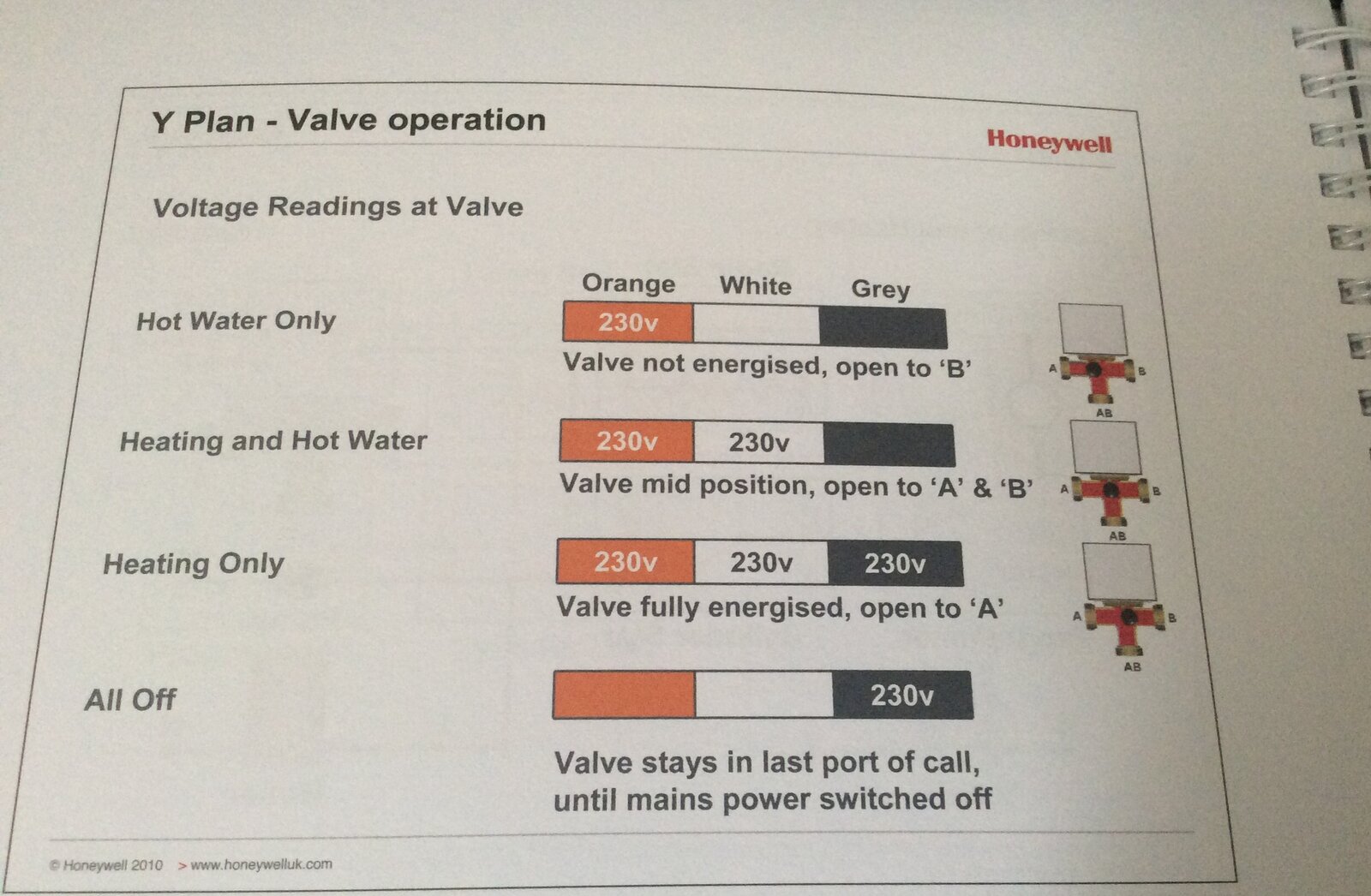

Using Volts AC on the multimeter, check the following:

Today, when I measured the voltage on mid position valve wires. I noticed that it was not seated properly/fully on the actual valve itself. So I got it on properly and CH is working!!!!!!
