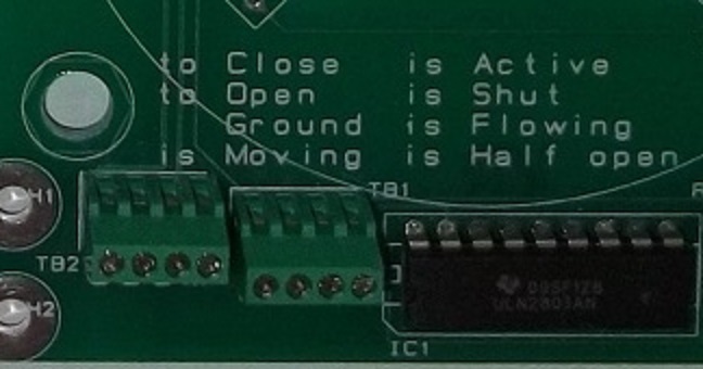

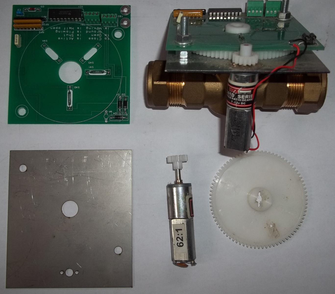

For what it is worth this is the actuator I designed for and use in the heating system in the cottage.
Operates on 12 volts. A magnet in the large gear wheel operates reed switches to (a) stop the power when the valve has reached the desired position and (b) create a status report back to the control system.
The status "Flowing" means the valve is fully open ( With hindsight "Full open" would have been a better label )

That is a quite impressive job Bernard, how long have you had it in service? The only part I would be critical of, is the lack of any proper bushing or bearings for the large wheel - that I could see.
I had in mind for my version using a normal 240v actuator motor for drive, relays and Hall Effect switches. Basically, fully self contained so it could be a straight swap over for a normal actuator. Your version obviously needs an external 12v supply and some sort of relay interface board.
I have designed the controller ( based on a MicroChip PIC 18F2620 processor ) which drives the actuators directly.
The layout of this cottage needed a bit of lateral thinking to achieve a reasonably efficient heating and hot water system.
I'd upgrade those reeds to digital output Hall sensors....a few boilers use reed sensing for DHW and primary flow, they suffer with the reed tines becoming magnetised. The Chaff Brittony goes into meltdown.
I had considered alternatives to reeds, either photo or hall effect, but reeds were the simplist to impliment. BUT I did have to add magnetic shunts to prevent the reed from operating until the magnet was alongside the reed.
I have vague recollections of that but in the millions of reed switches ( relays ) used in telephone switching I do not recall a stuck reed other than welded contacts due to a fault elsewhere causing the reed to switch excessive current.
