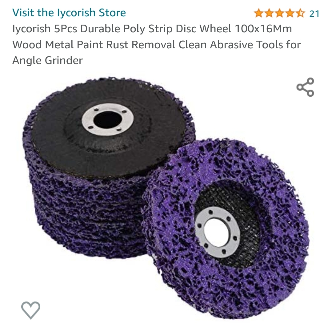

I'm wondering whether this will help remove the grout from the tiles..
Has anyone used this on porcelain tiles? It says it doesn't scratch the surface
As the grout dried quickly I couldn't wipe it with the sponge and I now have around 0.5mm streaks of grout along the lines.. (haze is when you have wiped it with the sponge)

Dont use white spirit or any other flammable chemical - flammable fumes can quickly fill a large space and any kind of ignition can cause a flash flame.
As recom above, Tile shop grout removing solutions are safe.
If I were you OP I'd stick with your original slow and steady - no danger, no expense.

Thanks for input folks.. I have used the poly disc on the angle grinder to remove the grout off the tiles.. 20 mins and 19m2 tiles are now clean.. thank the lord !!
Got myself some grout remover solution and scouring pads to smooth out the grout lines now.. panic over !!!
