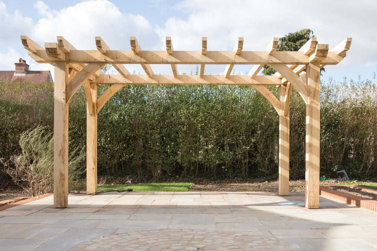

Thought I'd follow up on this for anyone who tackles the same challenge.
In the end I bought a drill jig but discovered on the day it didn't quite fit my drill! So the holes got drilled by hand and I had a second person stood to my side to ensure the drilling angle was about right.
I had 20mm stainless steel pins. I drilled using a 25mm bit (screwfix code 85314) at a depth of about 140mm (the pins were sticking out of the ground by 150mm). The fact that the hole had 5mm wider diameter than the pin was perfect, and meant we had enough space to lift the post on without it being so loose it moved afterwards. Obviously as soon as the horizontal pieces of oak were fitted, it all became rock solid anyway.
So the whole thing is deliberately off the ground by 10mm to protect the oak from standing water. If I did it again I'd probably go 20mm for aesthetics, but otherwise the design worked well.
Fun project if anyone out there is considering it...
