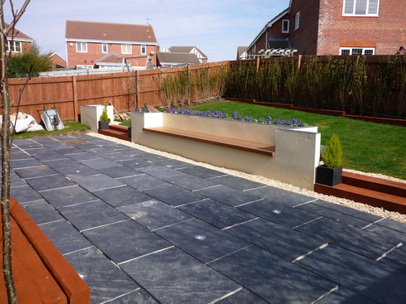

FWIW, here is the patio now...
It took me 5hrs to drill 9 holes for the uplighters.
