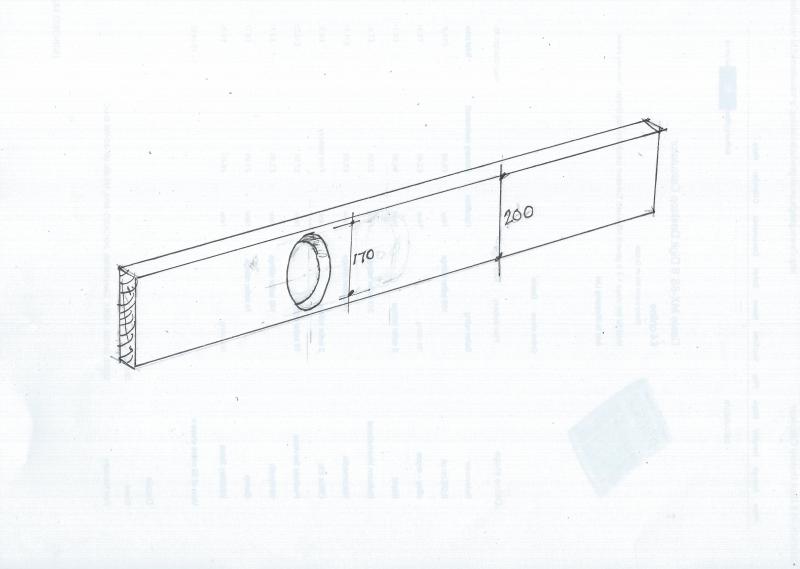

If you glue and screw a strip of something like 500mm plyboard to the sides of the joist, you can drill outside the limits suggested in the approved document
+1, most of the details i send out are commonly like this detail.
Structural grade plywood min 9mm usually glued,screwed and fitted over the area you wish to drill and around 500mm eitherside of the area.
The thickness of ply really depends on what the problem is.

Useful tip for anyone driling through a joist.
If it is near the centre of the span,it is not adviseable to do it like this. Hope this helps.
