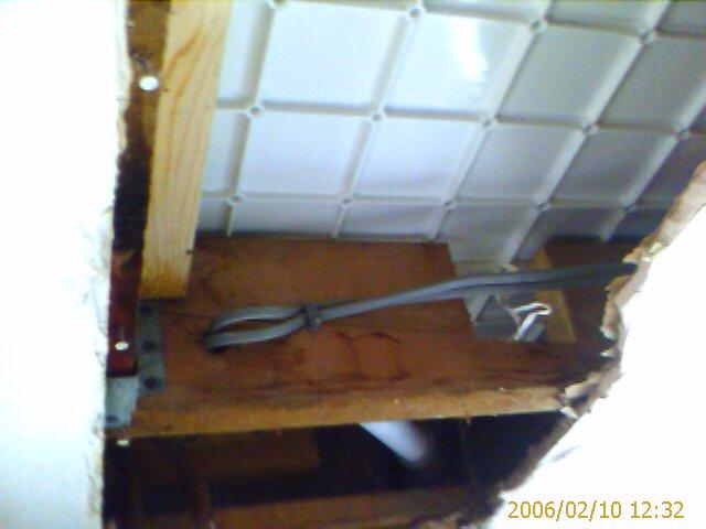

I want to put a shower in a small alcove upstairs, in between the front wall of the house and the stairs. Because of the stairs, the waste pipe can't just run between the joists. The drainage on the shower is right in the centre of the tray, so I would only need to cross one joist (which has in fact been tripled up, as I put a staircase to the loft and wanted extra strength).
What are the regulations regarding this?
Joist size is 7x2 with a span of about 4m or less. As I say, the joist has 2 new ones next to it (both ends supported, not just bolted together), so we have 3 in total next to one another. I'll post a drawing below, to show the layout.

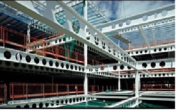

Don't make holes this big in wooden beams / joists but in steel these beams with large holes are almost as strong as the same beam without holes.

He's called Woody because he eats wood. Just look at the bite he took out of that joist beneath the shower tray.
Also as you are drilling through a triplex of joists do not make the pipe a tight fit in the hole. Allow a few millimetres of space around the pipe to allow for any movement of one piece of timber relative to the others. If it is a tight fit and there is movement then the pipe might be damaged.
Thanks very much for the replies, guys. I'll be sure to make it just over 40mm to allow for movement/expansion, halfway down.
