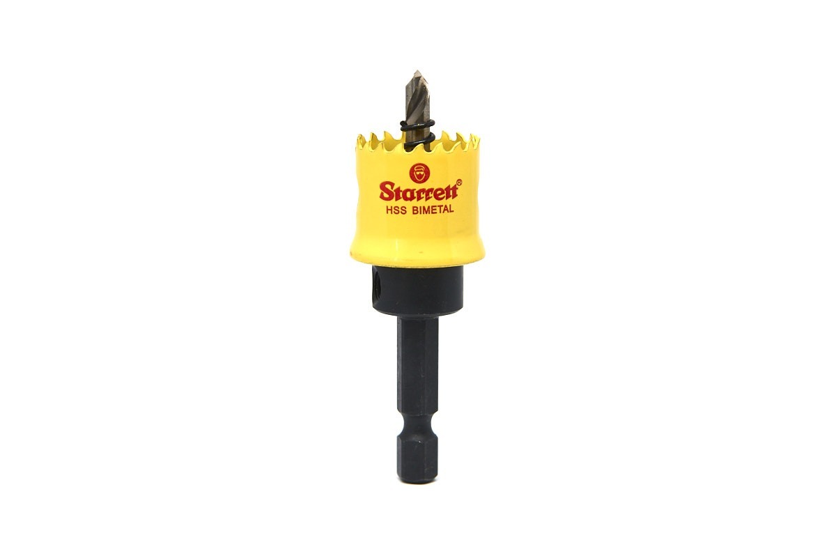

I am trying to run some cable in the ceiling to create a new lighting point.
However, I have a walls and ceiling held together by metal studs
Can the sparkies explain the easiest/ quickest way to drill through the metal to feed the cable? What bits/tools do need?

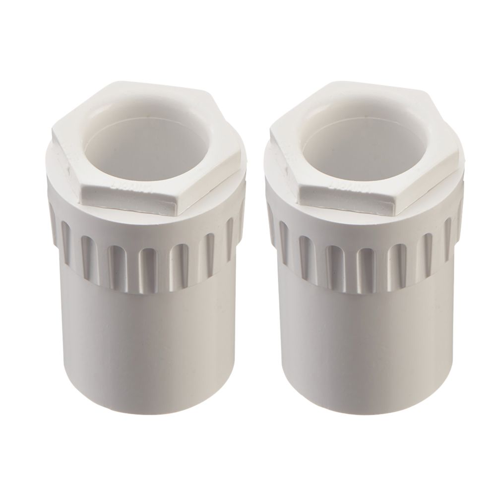

Also do I need to take any additional precautions to protect the cable as I anticipate that burrs will remain on the metal which could potentially affect the cable
20mm holesaw, then fit a 20mm female conduit adaptor in the hole.
Interesting. Has anyone any idea why it is said to be "specifically for cordless power tools?
I suspect that they are saying that the design has been optimised for cordless drills to allow more holes to be cut per battery charge.
Maybe !
I don't think they are saying that you have to use a cordless drill. ...
That would, indeed, make no sense (hence my question) but the word "specifically" does seem to imply it !
Maybe !
The recommended rpm is 175 to 800 rpm
Perhaps they want to discourage people from using corded drills with much higher RPMs. That doesn't make much sense though. My cordless Metabo has a max RPM of 3,000 rpm, that exceeds many corded drills.
Many thanks JW
