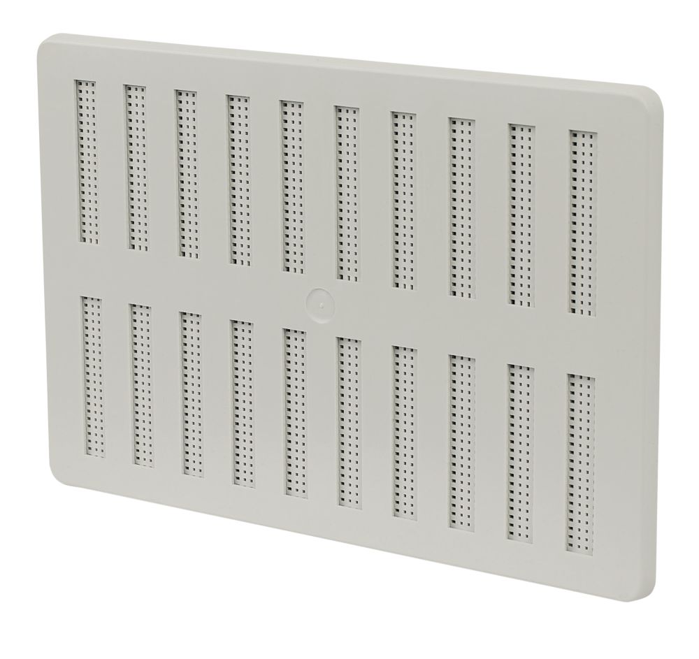

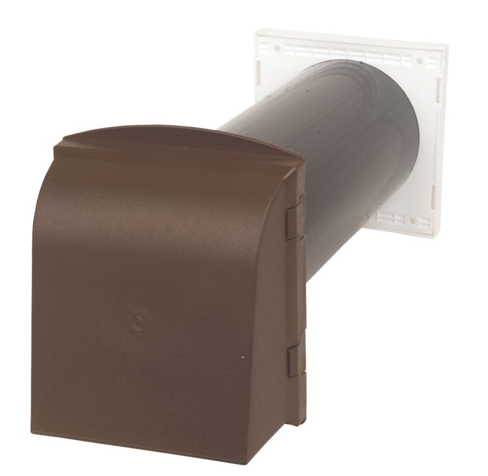

I want to rid a flat of condensation by fitting vents to the walls.
My first preference would be one of these
ae235
but then I'd need a 127mm core drill which is gonna cost me £50 (unless I hire one).
So I'm also considering a these
ae235
. They are the cheaper option and I wouldn't need a core drill. I'm thinking of drilling many 10 x 16mm holes through the cavity wall and then cover the holes with the above vent.
Is this a good plan, or am I missing something?

G`day Eddie,
The fitting of vents to get rid of condensation is a plan that works and works well. and to be honest the type of vent you fit in this situation is often simply a matter of asthetics.
You do also need to be aware that the fitting of a vent will also allow your lovely warm air to escape from your house so your vent need only be big enough to remove enough of the warm air to get rid of the condensation. and there may be other methods of curing the condensation (additional insulation for instance) even simply repairing your pointing can prevent air leakage causing cold spots & condensation. also upgrading the extraction to areas such as kitchens and bathrooms will be of great use.
If you are set on fixing a vent, Then you can drill several holes using a long bit through the entire wall, and break these out with a hammer and chissel and re point after (I`ve done it many times and hate it but the cost of core bits is silly)

I`m sorry I must have miss read what you were planning, I assumed you were going to fit a duct (pipe) through this hole an so you would be looking at making a hole roughly 150mm dia?
if this is the case I would mark where I want my duct to go including the outline, I then drill lots of holes along the circumfrence of the circle to "perforate" the masonry then knock this out.
as to your other plan of drilling many holes and fitting the grill over it, the issue with this is that you are then allowing warm moist air into the cavity which could lead to further damp issues any penetration through a cavity wall needs to be ducted and sealed to prevent this.
Ah, ok, well I'll go with the ducting then, thanks. Glad I asked now.
