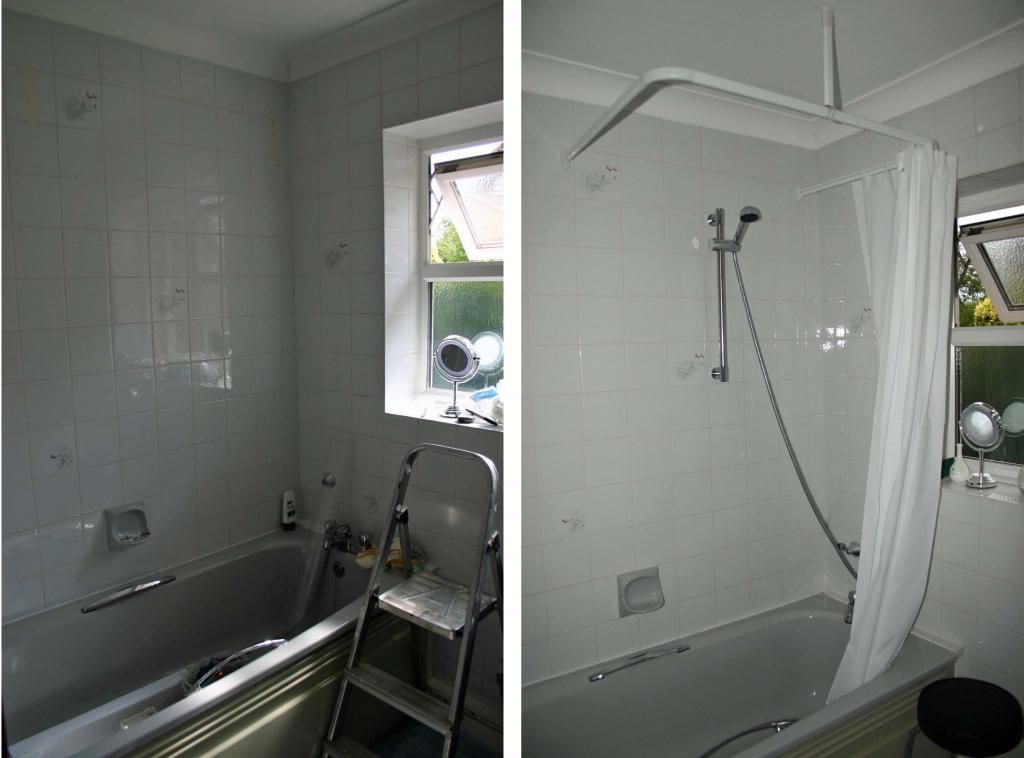

Hi,
Am to put up a shower in a tiled bathroom. Any tips on drilling tiles without cracking them please? :eek:
Masking tape over where you want the hole to be, use a good masonry bit, use a very slow speed until you are through the glaze......and no hammer action!

Thanks, it's only drilling to set up a shower booth curtain rail, and the shower head holder can be mounted on a wood block (for now) given several coats of gloss for waterproofing - so that again will only need screws to secure it. Will start looking for those drill bits.

Don't forget to push the wall plug right through the tile so it expands in the wall only and not in the tile which will split it :cry:
got some glass+tile bits :) 'PTX Universals'
what is the method please - drill the tiles with these, then swap to regular masonry bits once through the tile?
thanks
well i did - drilled each tile with the tile bit then deepened for the raw plug with a masonry bit. Many thanks - didn't crack a tile ;)

before & after:-
shower head lead too short and curtain too narrow but i can sort those bits later on - shower works okay, that's the main thing!
