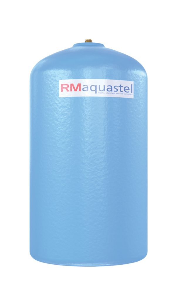

Also photos of your hot-water cylinder. What colour is it? Does it have a matching, smaller tank with a removable lid, on the top, with pipes running between the two? Like this one?
ae235
Or is it single-piece, like this one (no "waist")
ae235
