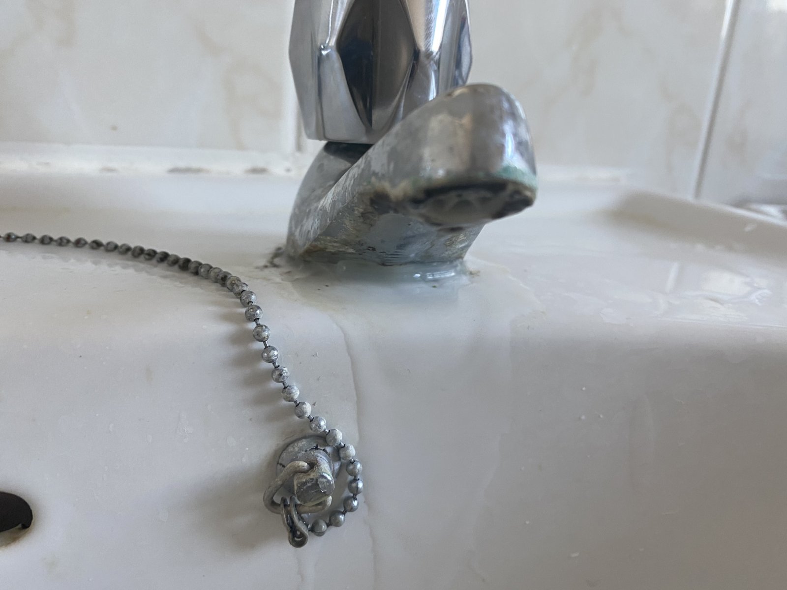

Hi all. Hope everyone is safe.
Sorry if this is a dumb question but my bathroom two has been dripping for a while even when it is tightly shut off. Do I need to replace the tap or what can I do?
thanks all
If it's a basin you'll need a 1/2" washer. It may just be a standard flat type washer but the washer type/shape can vary depending on the tap type you have so you'll need to take it apart first.
Are you in a hard water area? If that pic's anything to go by you'll need some serious limescale remover before you start.
Depends on the valve ,they vary .You would have to remove it to find out.
Thank you both, yes I am in a hard water area the dripping just annoyed me and the mess it makes throughout the day! just a quick one I have removed the cap and the screw but came seem to lift the nob off? do I need to switch the cold water off
Yes you need to isolate water before removing valve from tap .The knob is probably fused to the spline of the valve with limescale. Pouring very hot water over the knob may expand it a bit
and aid removal.
Sometimes it's better to just buy and fit new taps.
Get tap revivers as stated above. Much simpler. although my preferred method would be replace the taps as them type are dirt cheap and you’d do it in the same to replace the washers.
