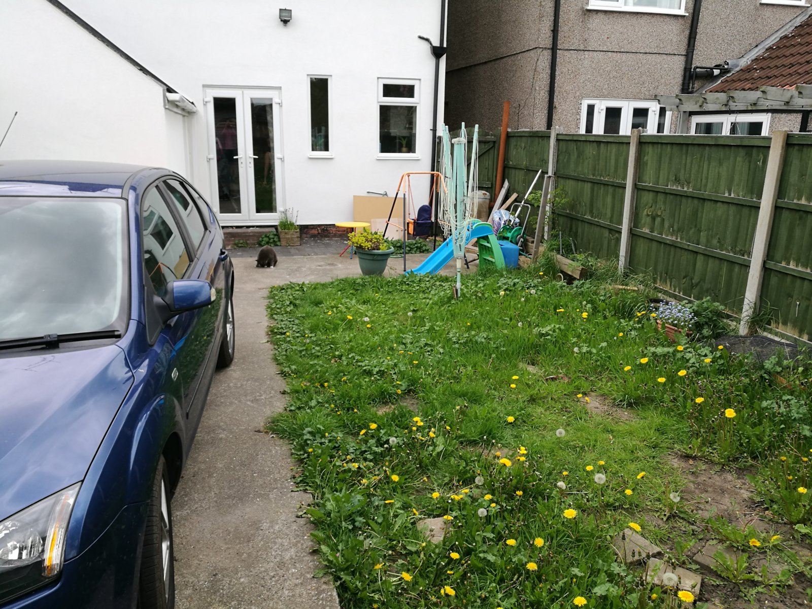

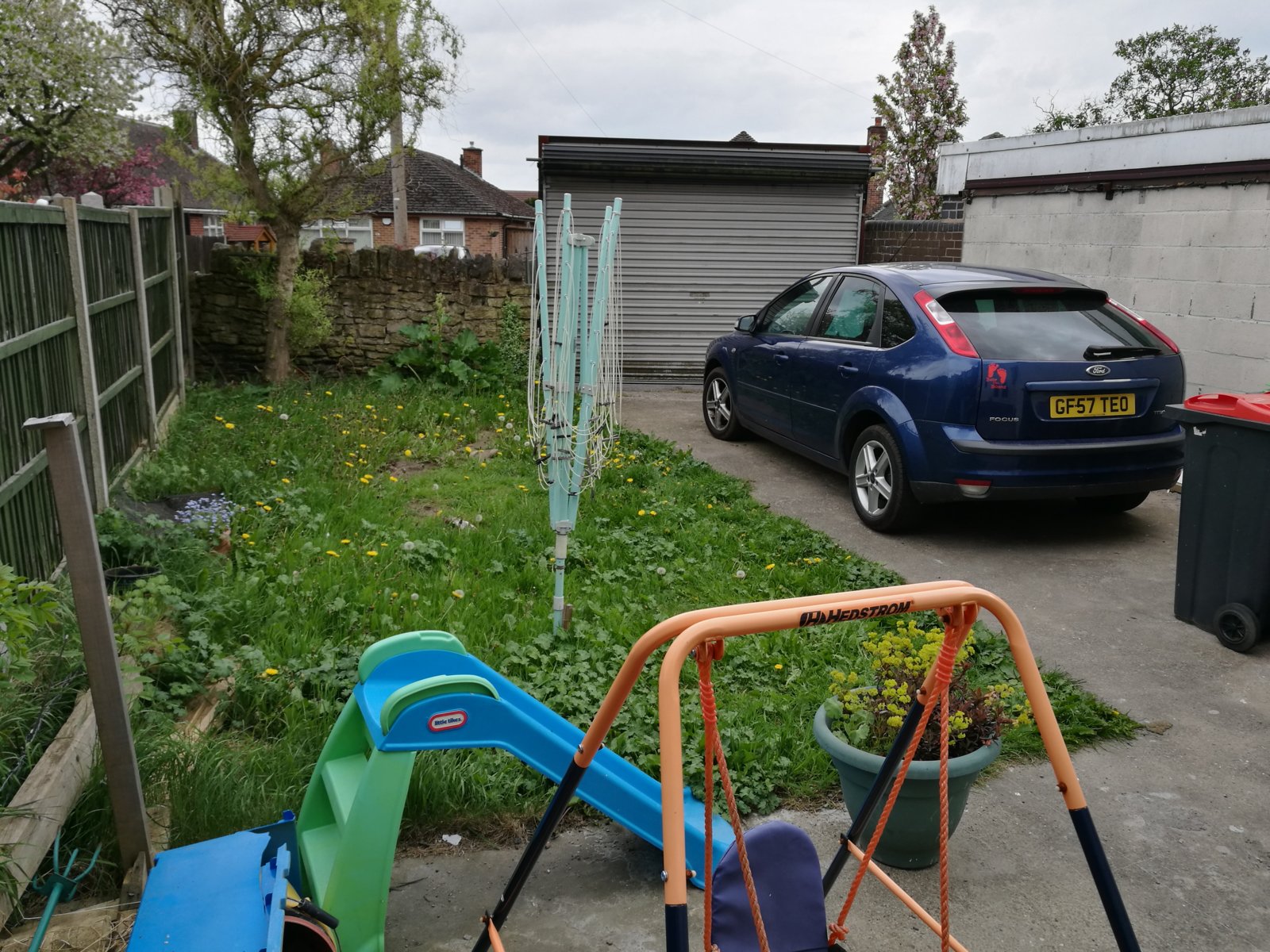

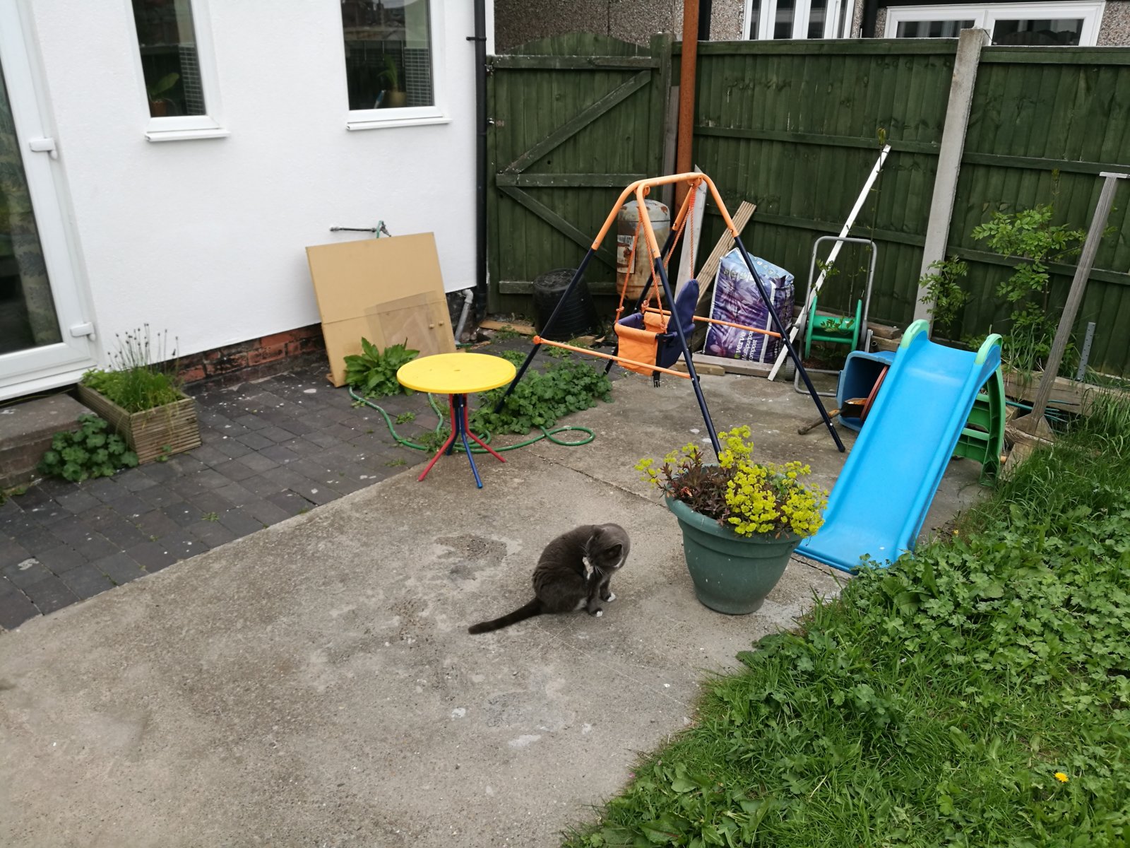

Hello this is my sorry looking driveway. The plan is to build a waist height wall where the grass meets the swing and slide, swing & slide area will be artificial grass and the rest will be block paving or slabs of some sort.
I had two quotes for Indian sandstone. One builder wants to leave the existing concrete down and build on top of it and the other wants to pull it all up. £3,500 and £5,600 respectively.

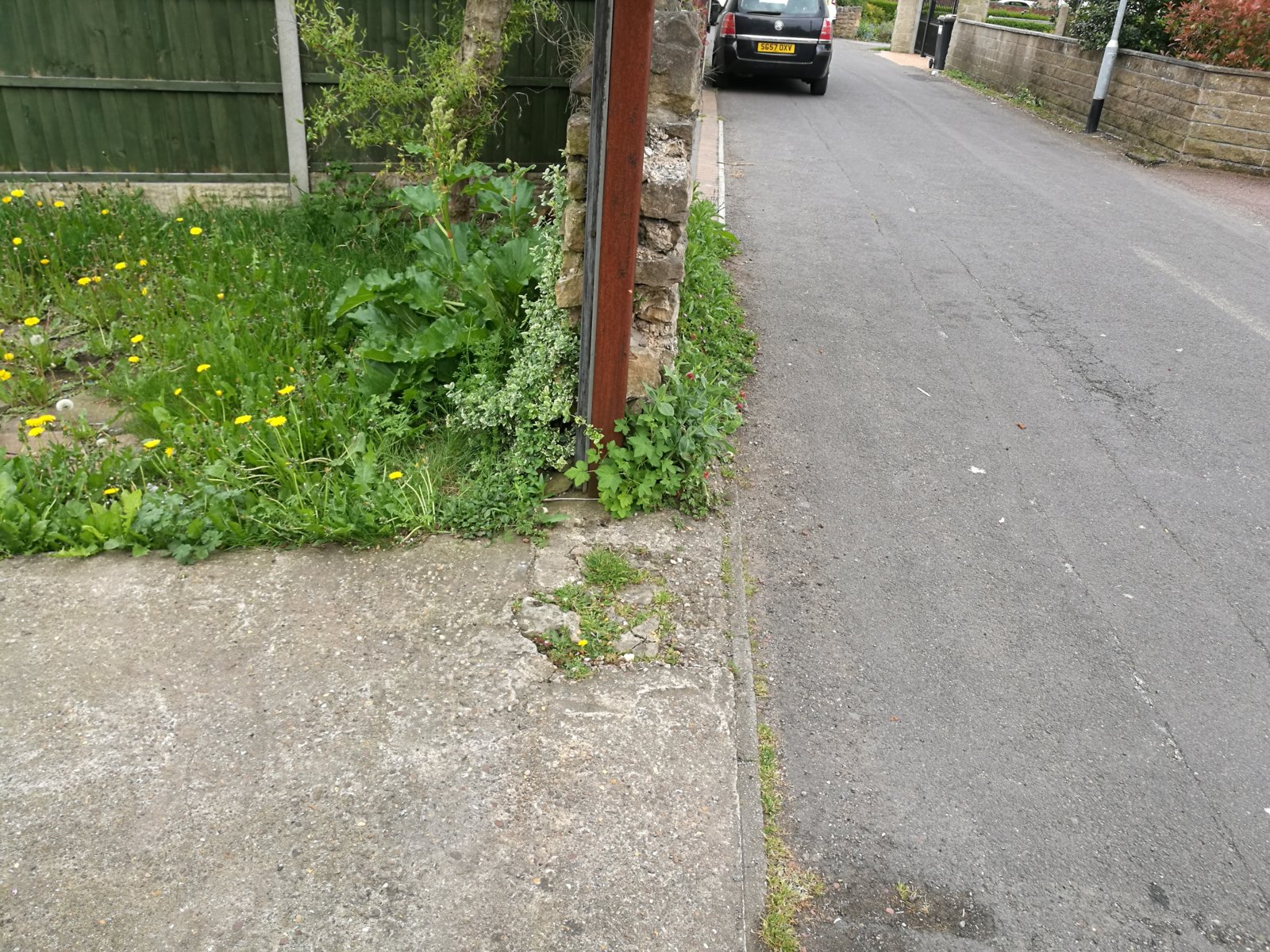

Would it be ok to slab on top of the concrete? Also in one of the pictures you can see where the driveway meets the road, how would a step up work? I think it would look messy.
The sandstone I saw is from jewsons at £17.50 per sqm. Is there a cheaper option?
Total area is around 55-60sqm to slab.

You can go over the concrete as long as it's properly cleaned and prepped to receive the bedding layer.
Good to hear, that's £2,100 saved!

£3,500 looks a good quote then if going on top of the concrete is ok. I'll have to ask him how he would do the step up from the road.

The old 3'x2' concrete slabs will crack if enough weight rides over them and/or the base is too soft and allows movement. I'd be very wary of using anything thin, any slight movement and they'll snap like matchsticks. Block paving is a minimum 50mm thick for a reason.
If the surface you are paving onto has cracks or joins in it, the new paving will crack at that point because there will be movement. You can manage it by putting a break in the slabs, but you'll be lucky if the base crack is in a neat straight line. This will be a problem with your old concrete which is quite large and has angles in it.
Paving bricks are more accommodating of slight movement.
I'm leaning more towards paving bricks now, about £20 per sqm and 50mm thick.
