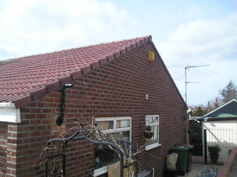

Dry fix system vs traditional mortar ?
If you dont fancy the dry verge system, why not try a cloak verge system? they are not that much more expensive than dry verge
Hopefully i too would be adding these to my roof, its all added cost to make the roof look beautiful :LOL:. My Neighbour has Redland REGENT tiles on his roof but i'm looking to have the Redland Double Pantile or Double Roman tiles installed (i hate choices lol :D ). Are these tiles interlockable with Redland REGENT tiles?. I don't really want to fit the half round ridges between the two roofs to make a hip, just makes it Look ugly :(
